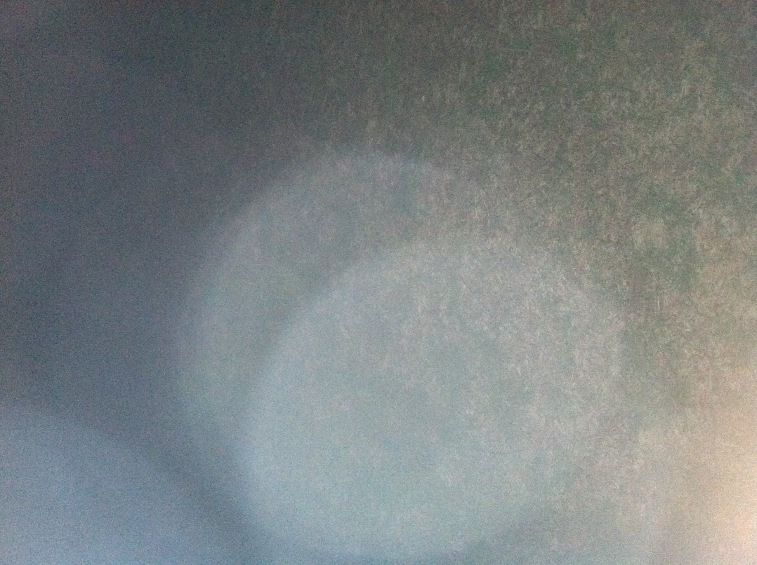

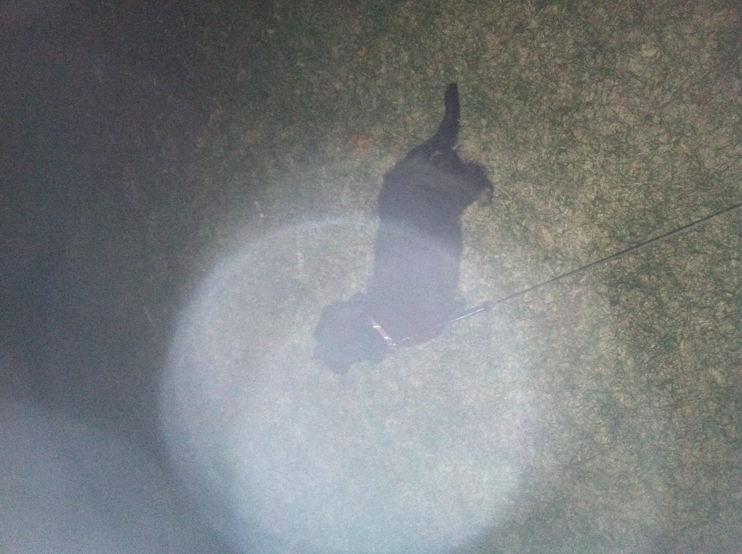

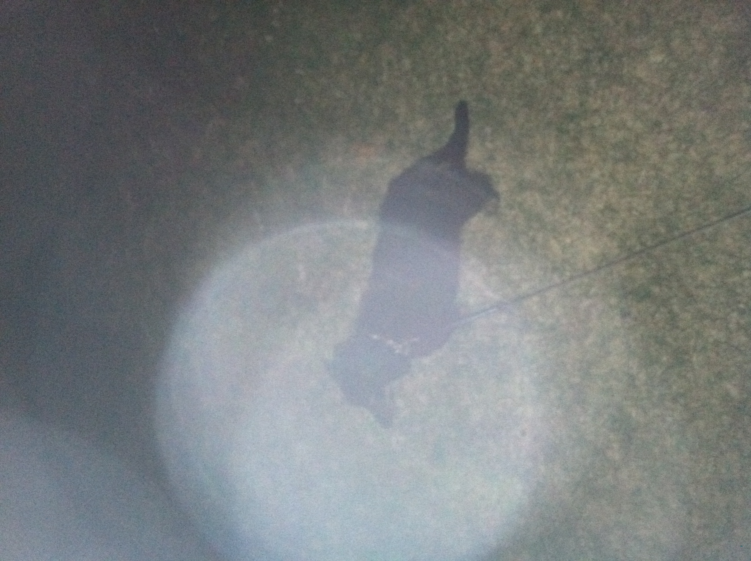

For some reason my iPhone 4 flash camera is suddenly acting very strangely when taking pictures. I've never had this problem before and I can't seem to figure it out. I tried rebooting the phone etc... but it still occurs
Looked around for threads about this but the only one I saw the guy never said if he got it fixed or what ended up happening
As you can see from the photos the flash is creating a huge bright spot on the side whenever it goes off. Tried different angles, moving my hands, moving the location, taking off the case I had on and it still happens. Should I just go to the apple store do you think they will replace it?

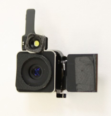

Looks like you've got some dust between the lens and the camera. Try taking the back off the phone and giving it a good puff of air. There is a seal around the camera that should've prevented this, check to be sure it does not need repositioned.
