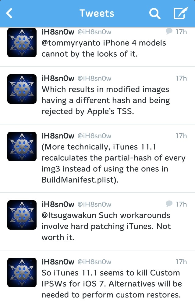

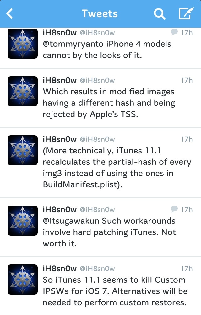

From the last few days on twitter, it appears that iTunes 11 breaks custom restores. Try using redsn0w to restore?

Reading ih8sn0w's tweet again, he says it only affects you if you're on iOS 7 AND using iTunes 11.1
