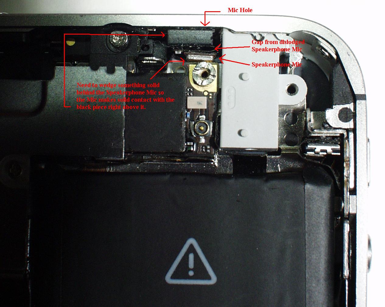

For those of you where the 'stick something down the speakerphone mic hole' didn't work, as it didn't on mine, most likely, it is a mechanical problem. If the speakerphone mic becomes detached for some reason, the mic will not work and the symptoms are exackly as described here in this thread. Mic doesn't function with speakerphone on, motor boat sound in videos.
My speakerphone mic stopped working after I replaced the earphone jack in my 4s. The speakerphone mic is part of the earphone jack assembly, and I noticed while removing the defective earphone jack, that the speakerphone mic was tightly glued to the little black housing (sound amplifying chamber?) above it. After the replacement, the mic was no longer tight up against the black housing.
After wedging a piece of plastic behind the mic to get it seated tight up against the black housing, it came back to life. See attached picture for reference.
This fix does require removing two very small screw inside the phone next to the mic, so good luck if you do this.
