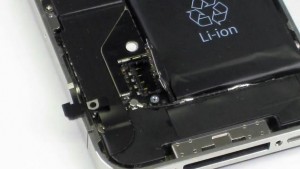

its the wire like i said.......it clicks in next to the battery.....re-seat it
according to iFixit it is the antenna contact that you remove from the phone when you pry up the battery connector. then you remove the "antenna contact" thats the little part that usually goes flying!! lol but Dee is correct also cause the wire is called the "lower antenna connector" so check them both!
