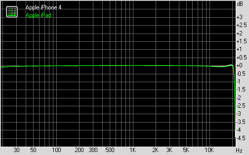

I don't know if it has less bass, but I think the Iphone 4 sounds better in general, and I'm a bit of an audiophile. I'm pretty impressed, I think it sounds fantastic.
Doing some research, it appears that the Iphone 4 (and Ipad - they share the same audio chip) really does present better audio - it's a much flatter frequency response than the 3G, which colors the audio quite a bit.
(Stolen from here, where you can read more about their impressions.)

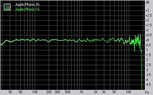

Compare that with the graph for the 3G:
Big difference. Not that it was bad, but the Iphone 4 is really good.
And that might be why you think it has more bass - it has falsely bass-y audio, apparently. What you're hearing from the Iphone 4 is more natural sounding. This should be a good thing. I understand that you're used to the 3G's sound, but give the Iphone 4 some time and then listen to the 3G's output. You might understand how odd that altered sound feels to your ears after hearing something this accurate.
I think its also the fact that the iPhone 3G, from that spectrum plot, has a much lower frequency LPF applied to it. You'll probably find the ultra-sonics left in on the spectrum of the iPhone 4 mean that the top end is more noticeable than on the previous handsets
Wow. That's pretty impressive.

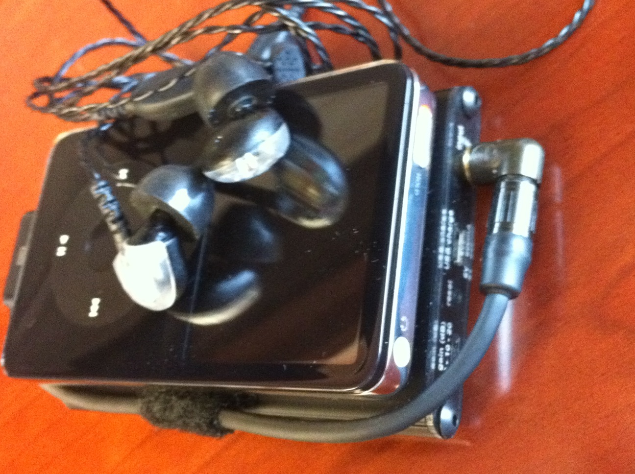

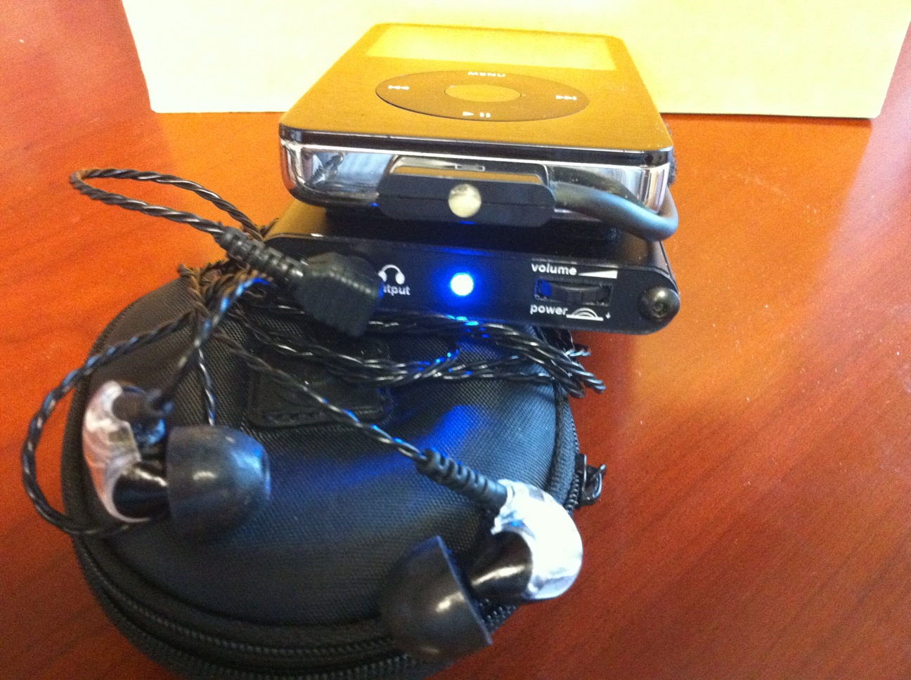

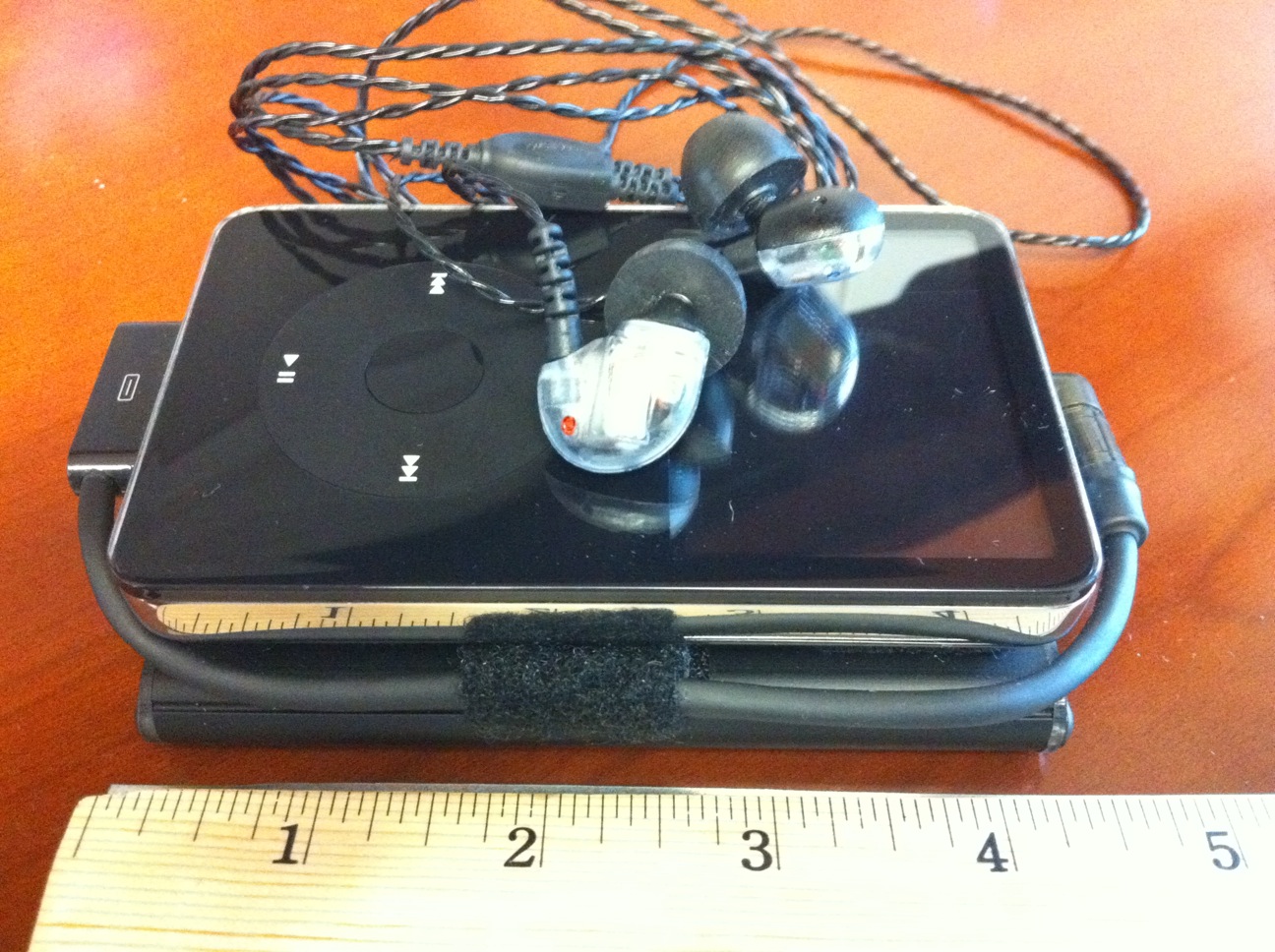

For hi-fi portable music, you want to get a 4th Generation or 5th/5.5 generation iPod as they contain the high-quality internal Wolfson dac chip. These are the best sounding iPods made. Apple decided not to continue with the Wolfson dac after 5.5. Then you need to add in a nice portable amp, good cable and great phones. As m3coolpix said, checkout Head-Fi.org forums but make sure you have a big wallet.
My portable rig: 80GB 5.5 Gen iPod > Cable Pro Ear Candy Lite cable > TTVJ Slim portable Amp > Westone UM3X monitors.
Enjoy....your music has never sounded so good!
