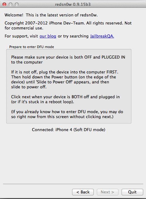

Here's a screen cap:
Extremely frustrating! Nothing can get it out of soft DFU or restore and activate even to STOCK iOS in iTunes
