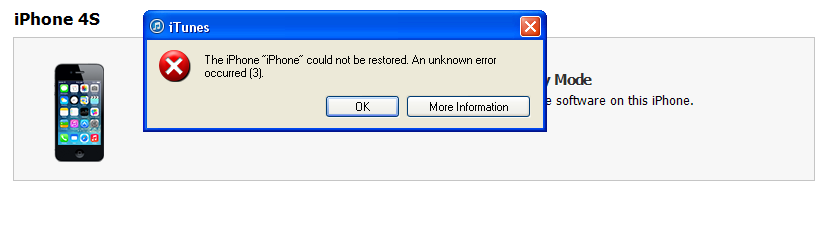

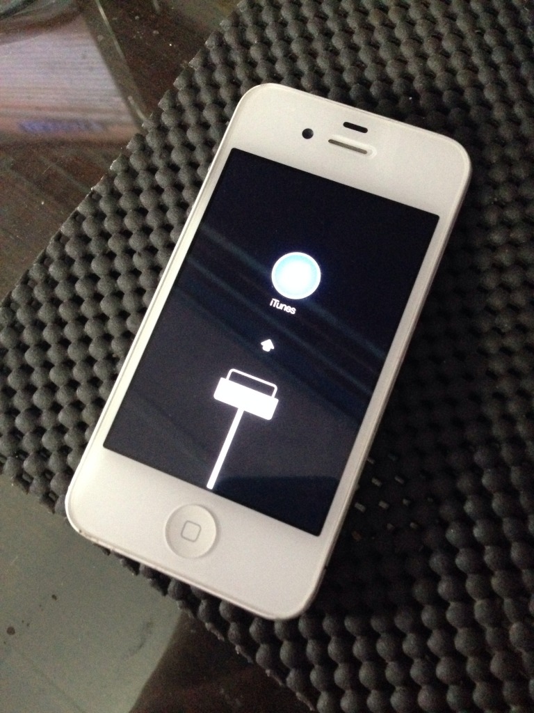

Hallo, i have a problem.
My iphone 4 stuck in recovery mode. When ios 7 come in official, i upgrade my phone to ios 7, and then 5 days ago my phone stuck ini recovery mode.
I try to restore with ios 702, and restore ios 703 tonight but my phone always stuck in restoring iphone firmware.
I try use tinyumbrella for exit recovery mode, when i click exit recovery mode, iphone just reboot and recovery mode again, but when i try restore again come error 3194. Edit host not help. error gone, but stuck again in restoring iphone firmware
Just try recovery mode and DFU mode before restoring ios but always stuck restoring iphone firmware around 75% loading bar.
Help me please :(
*i use latest itunes, good connection, original cable, and try restore in 3 different computers.

I just googles that 3194 error and Apple has a page with a suggestion on how to fix it:
http://support.apple.com/kb/ts4451
Give that a go and see how it works out.

Hey Alex
Yeah tonight after i use exit recovery from tinyumbrella i have error 3194.
So i edit host like i see in google, edit host not help anymore. Error gone but i 'stuck again in restoring iphone firmware' like in a picture.
Thanks Alex!
try use iReb to get out from stuck recovery mode, and this time don't do DFU mode to restore, use recovery mode to update to ios7, make sure your host is directed to 74.208.105.171 gs.apple.com (no # symbol before 74.208.105.171) I have done this a while back and it work, good luck

ok, Vince. i just edit host. now i have error 3004.
now i try to fix it.

ok, error 3004 normally indicates that it can't communicate to gs.apple update server, first thing first, i would check your security/firewall setting not blocking port 80 or 443 or try use a different pc/mac if that helps.

Hey Vince, i don't know what happens..
But i just realized, now before i try to restore i use redsn0w to see iphone status,
1. When status recovery mode, i have error 3194
After Edit host, stuck in 'restoring iphone firmware' as usual
2 But when status in redsnow DFU/soft DFU and i not edit host, iphone direct in restoring iphone firmware and stuck again
3. In DFU/soft DFU and i edit host like u said, i have error 3004..
I've been confused and tired:(
I haven't try iReb, because here 2.38am. Need go to sleep, and when wake up i try use ireb!
Thx again Vince
Case closed. Now finally iPhone running iOS 7.0.3
I open back case, removing battery and i plug it back.
Restore ios 703 and not stuck in restoring iphone firmware hehehe
i have same problem with my iphone. stuck when restoring firmware about 75% . are you replacement with new the batery ?

Worked a treat for me too. I just replaced the battery with a new one and boom, it restored perfect first time!
Thanks for the detailed and informative pictures and for taking the time to come back with a final result!
