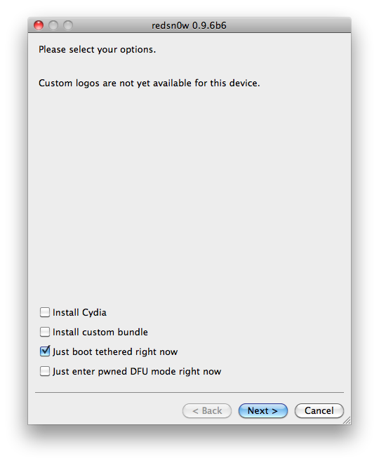

The new jailbreak is tethered. Meaning every time your iPhone needs to be rebooted, you turn it off/on, or the battery dies you need the software to turn it back on.

i understand this but to be able to boot from redsnow the phone has to be off which as far as im aware i cant turn it off with out being able to slide the bar to accept turning it off.
The iPhone doesn't have to be off. Once your iPhone rebooted after finishing the Cydia updates, is when you needed to run redsn0w in tethered mode to turn your iPhone back on.
when i go into redsnow app. it has the option "just boot tethered right now" when i select this it asks me to make sure the phone is off before continuing but since i cant turn the phone off how am i meant to ensure this?
Ignore the "turning iPhone off" bit. Go to the next page and follow the countdown.
