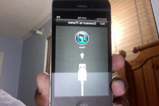

Thanks for your advice. I just tried to reload software using pwnage 5.0.1 Only thing is I cant get past the initial set up.I choose language, enable location and then the next screen it says connect to itunes. When I do that it just hangs. I guess this is my last effort.

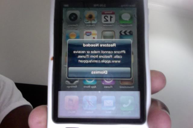

Yeah. I tried a pwned-DFU restore with iTunes stock software and get the (-1) error code. But when I do a custom restore i can get to the springboard but after a while the phone shows this message. It says 'Restore Needed' Sorry if its reveresed. I will try to take a better picture. Also on both of the successful restores from iTunes "wifi and Bluetooth' worked.

This is as far as I can go when I use redsnow to jailbreak. But if I use Pwnage I can get to spring board with no wifi option.
