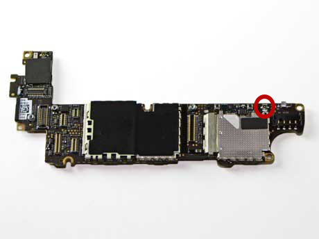

The only way to tell for sure is to open the phone and check the connection, but it sounds to me like the speaker is just shot. There is a lot of shiny copper on the Logic Board, and well we all know what happens with a penny in water.
The connection in the pic that is circled is your speaker connection. I do believe that is a pic of a 4S but it will look the same and be located next to the battery connector.
If this is is burned out it will look black, or even have a green looking mold and its shot. If its clean the the speaker burnt out. Hope this helps!
The connection in the pic that is circled is your speaker connection. I do believe that is a pic of a 4S but it will look the same and be located next to the battery connector. Image
