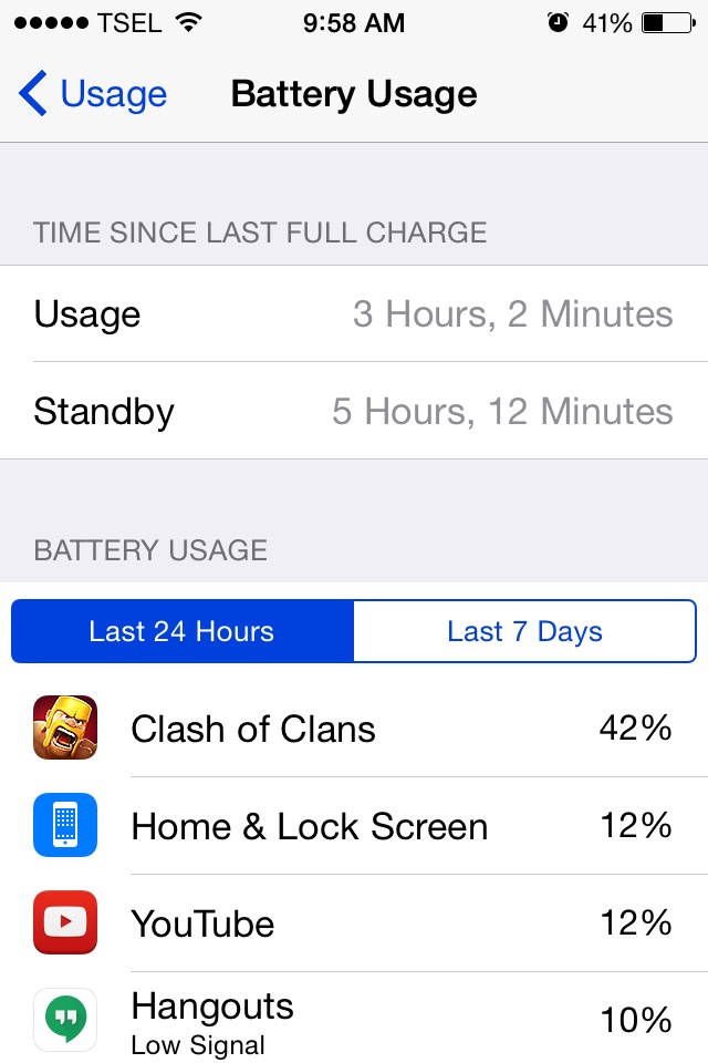

This is my i4s battery life. My battery is 90 cycle count.
Fully charged at 5 AM this morning. I do a lot of gaming COC, watch videos on youtube and browsing. And then, at 10 AM it run down to 40% with 3 hours usage.
I just wanna know if my battery is normal or not.
If anybody want to share his battery life too, it would be nice 🙂
Thank you.

Looks normal to me. I always got 6 to 7 hours out of mine, but with no movie playing and only light games like wordfeud and puzzlers. You could dim the screen more if you want to squeeze more out of it. Also, you can use backupbot to obtain the exact battery stats.

I have tried using ibackupbot sir. I checked twice with my office and personal computer, then I've got the different results.
On my office:
CycleCount: 90
DesignCapacity: 1430
FullChargeCapacity: 1300
On my personal computer:
CycleCount: 90
FullChargeCapacity: 1400
it's kinda weird, so I decide to post my battery usage 😀
I'm using iOS 8.2 btw, and i disable all the animation except transparency.
Yes, that's strange. There's always some fluctuation in full charge capacity, but 100mAh seems like a bit much. Since the battery is still new at 90 cycles, I'd think around 1400 is probably right, unless you run it down to zero every day. I wouldn't worry about it. You could check with backupbot every now and then but i bet it will stay around 1400 for quite a while.
