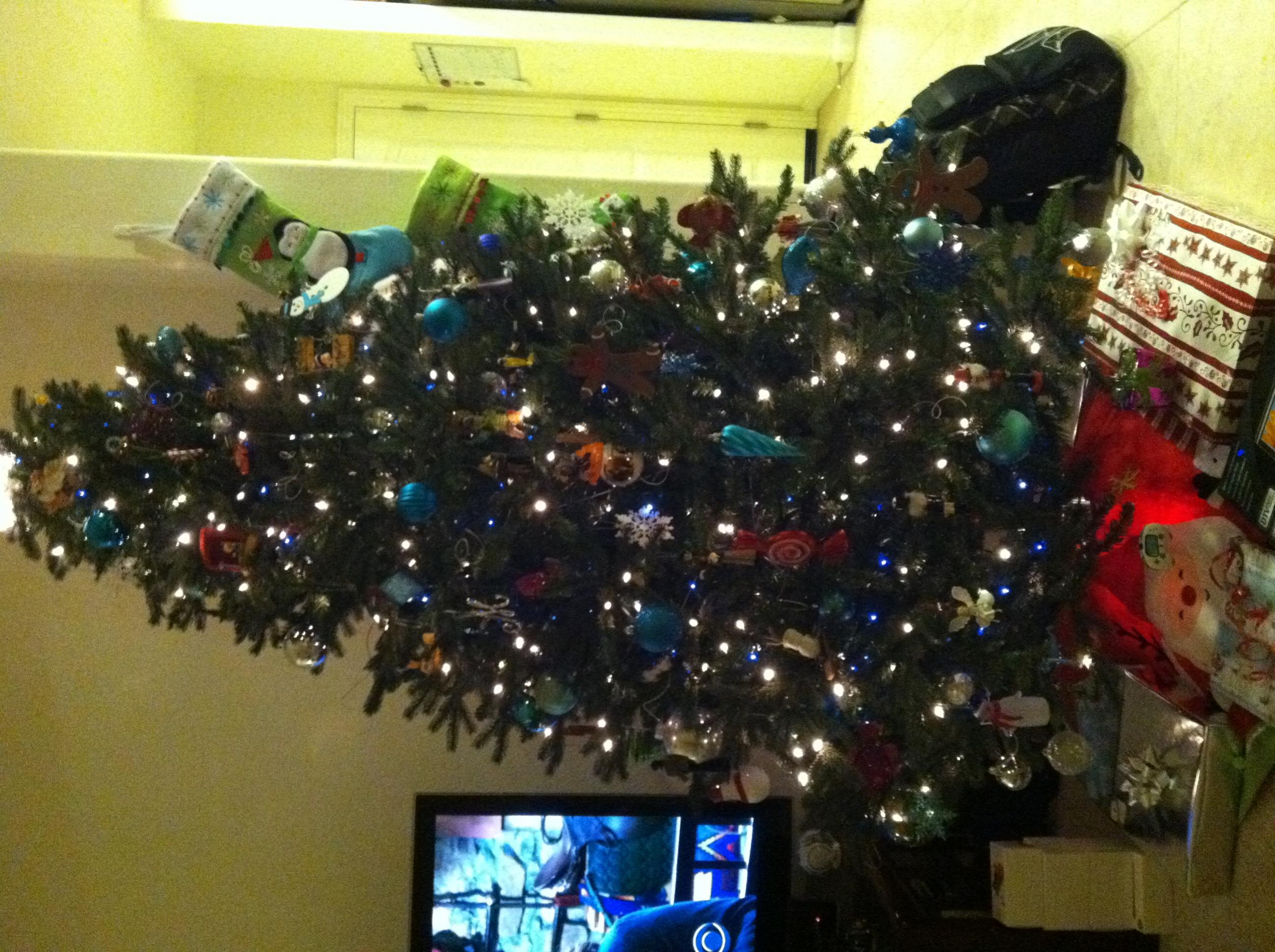

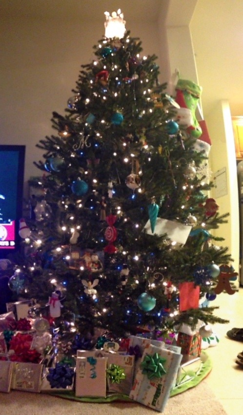

Same issue with the iPhone 4S camera! My 4 took way better pictures. It's better at motion and low light when compared to the 4S. I used the iPhone 4 at Harry Potter Land where most of the shots are low light action. Majority of the photos came out great! Most of the people who've seen the photos are shocked it's an iPhone. My 4S can't even handle taking a photo of my still Christmas Tree is medium lights with it's lights on too! Hella noise and blurry detail. I uploaded it! One thing is for sure better on the 4S, White Balance! The 4 makes my house look yellow, but the 4S shows it as white.
For some reason one of the photos showed up sideways, but I want to let y'all no I'm not an idiot. It's the website. It is correct on my Mac.
1st photos 4, 2nd photo 4S
