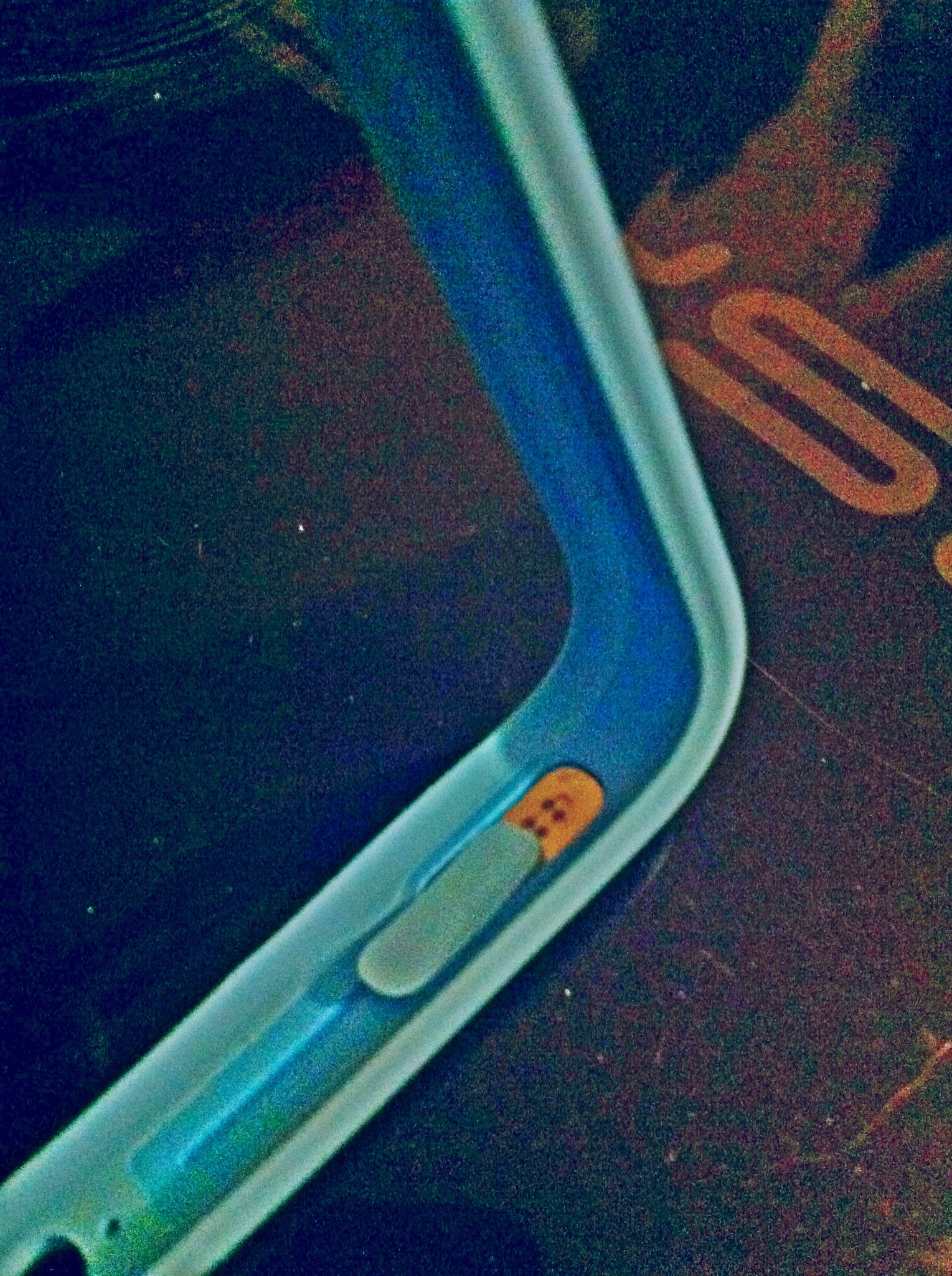

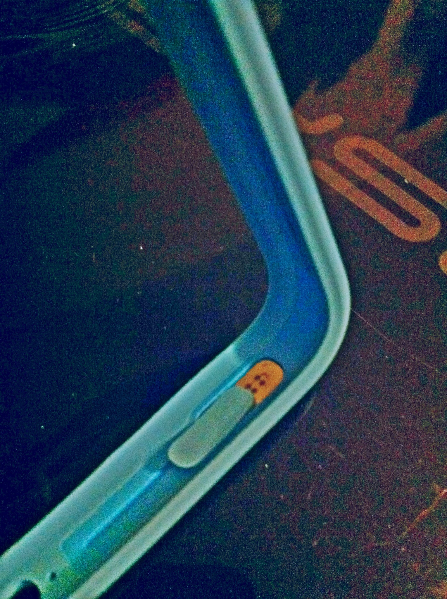

I know it's late but here is the fix. I just found this out today, wish I had owned an iPhone when it first came out. Would've helped a lot of ppl with this problem. I did not come across this fix anywhere else, found this out myself.
Fix: there is a sticker under the power button of the bumper, get a small pin or exacto knife, carefully peel it up. This should reveal the metal piece. In doing so, creates more space between the bumper and the iPhone allowing for some wiggle room.
