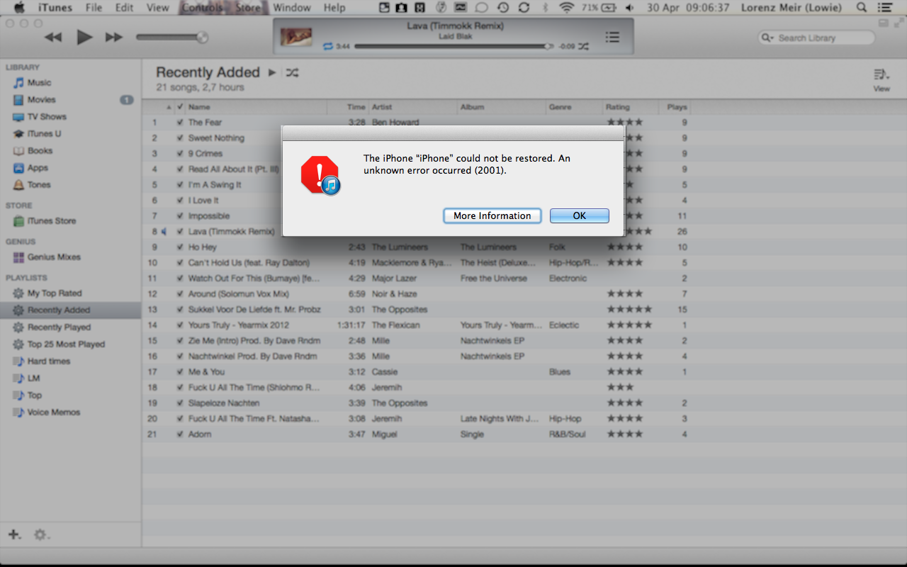

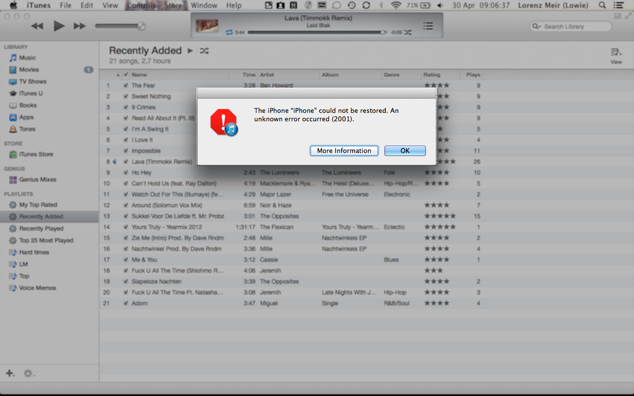

My iPhone 4S keeps getting the error '2001'
I try to restore it with my MacBook Pro Mid 2012 running on the latest OSX (10.8.3)
The iPhone has no battery anymore because it's dead but I read on the internet as long as it is connected to a power source, the phone would be able to boot.
I tried a hard reset but that didn't work either.
I have the latest version of iTunes and Quick Time, my firewall is turned off, all other USB devices are disconnected and restarted my computer...

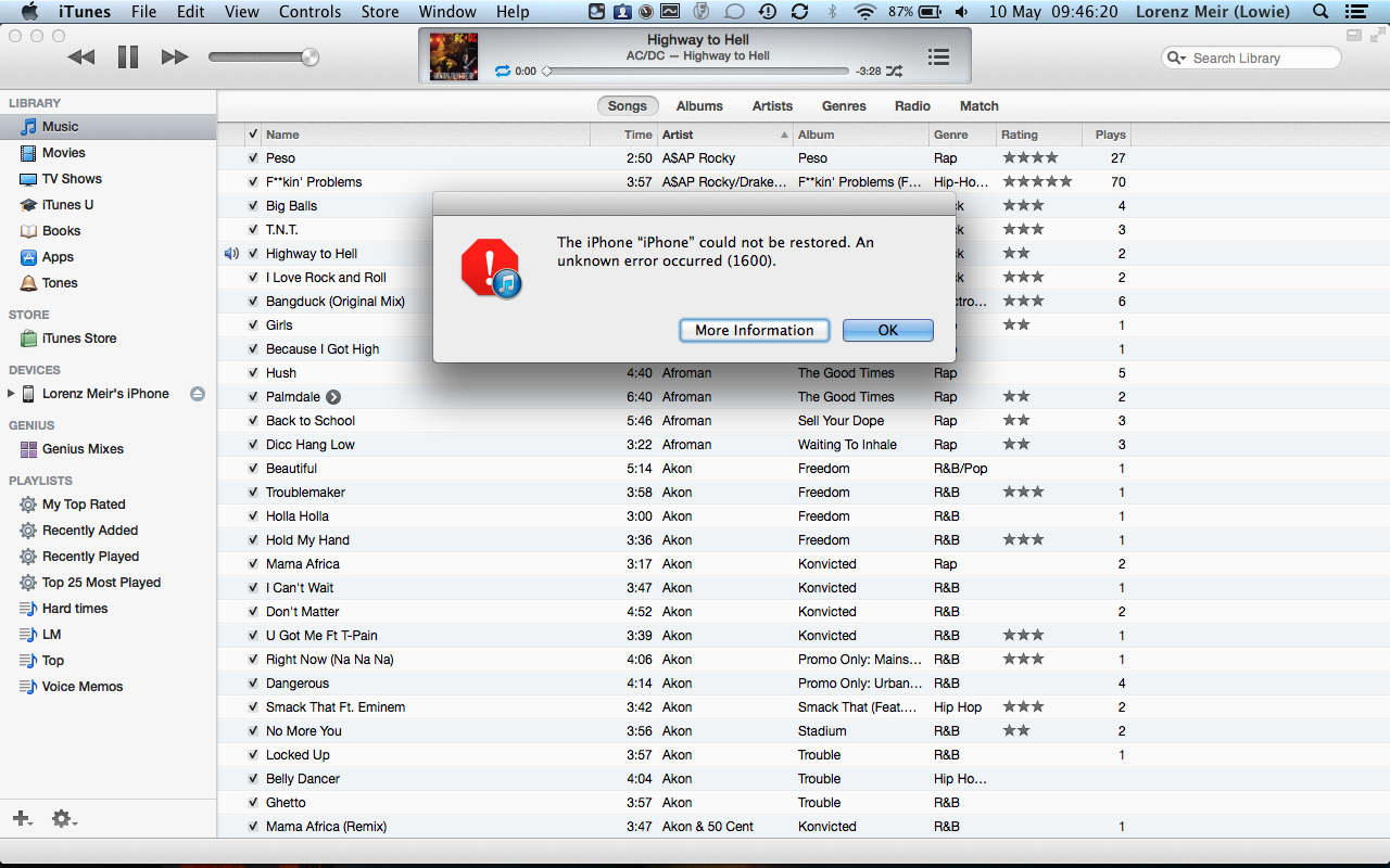

I manually restored the phone to 6.1.3, this failed.

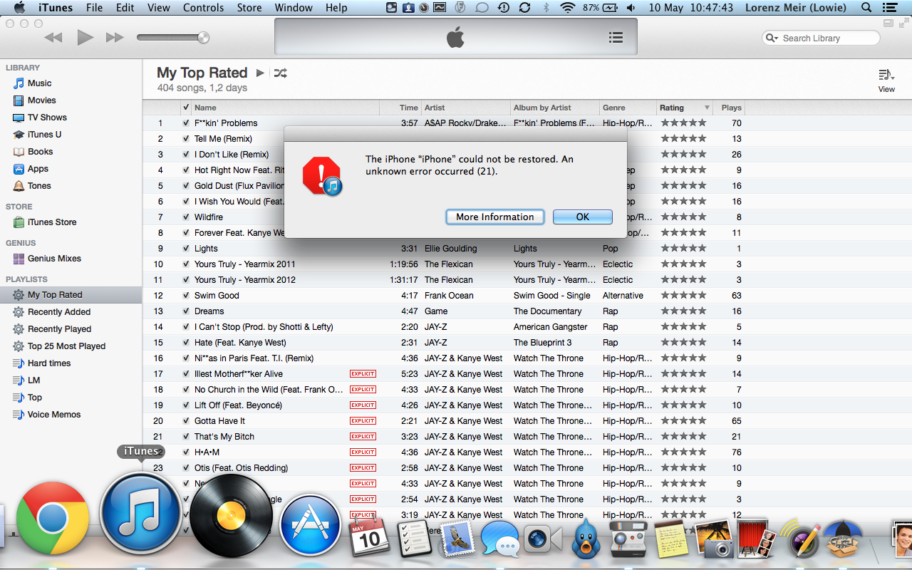

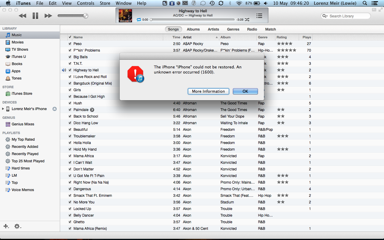

After messing with TinyUmberella and RedSn0w I'm having new errors:
error 1600 in DFU mode and error 21 in recovery mode...

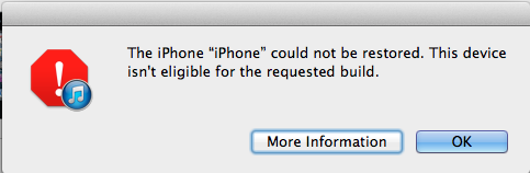

Oh god, I'm messing it up... Tried to restore to 6.0, now the phone only flashes the Apple logo for a couple of seconds, shuts down and does the same over and over...
The iPhone doesn't show in iTunes either...

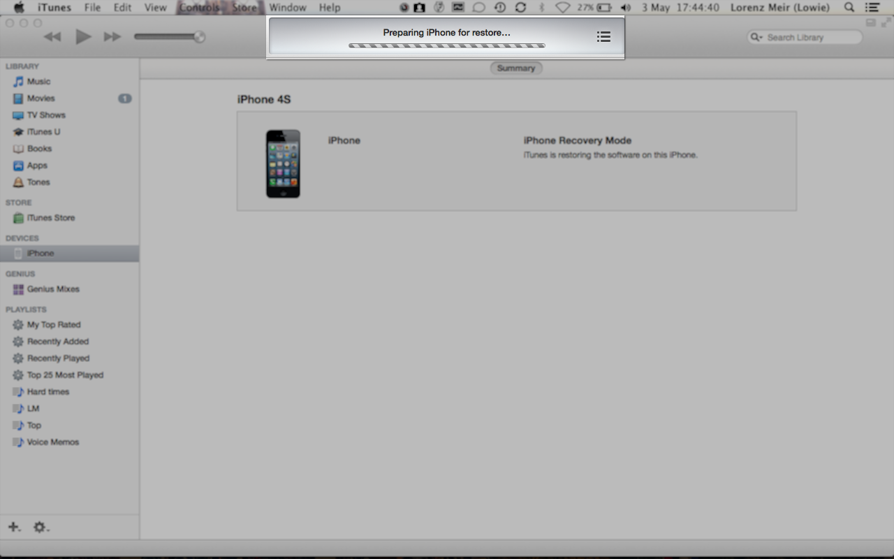

I held the home button down for some time and now the CONNECT TO ITUNES screen is back, disappearing after a while and starts to flash again...
So I repeated the process and connected to iTunes and tried to restore to 6.1.3, now the phone is able again to keep the CONNECT TO ITUNES screen...

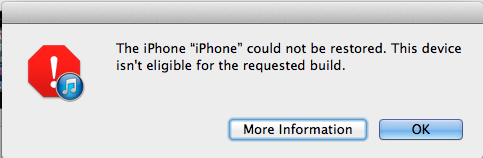

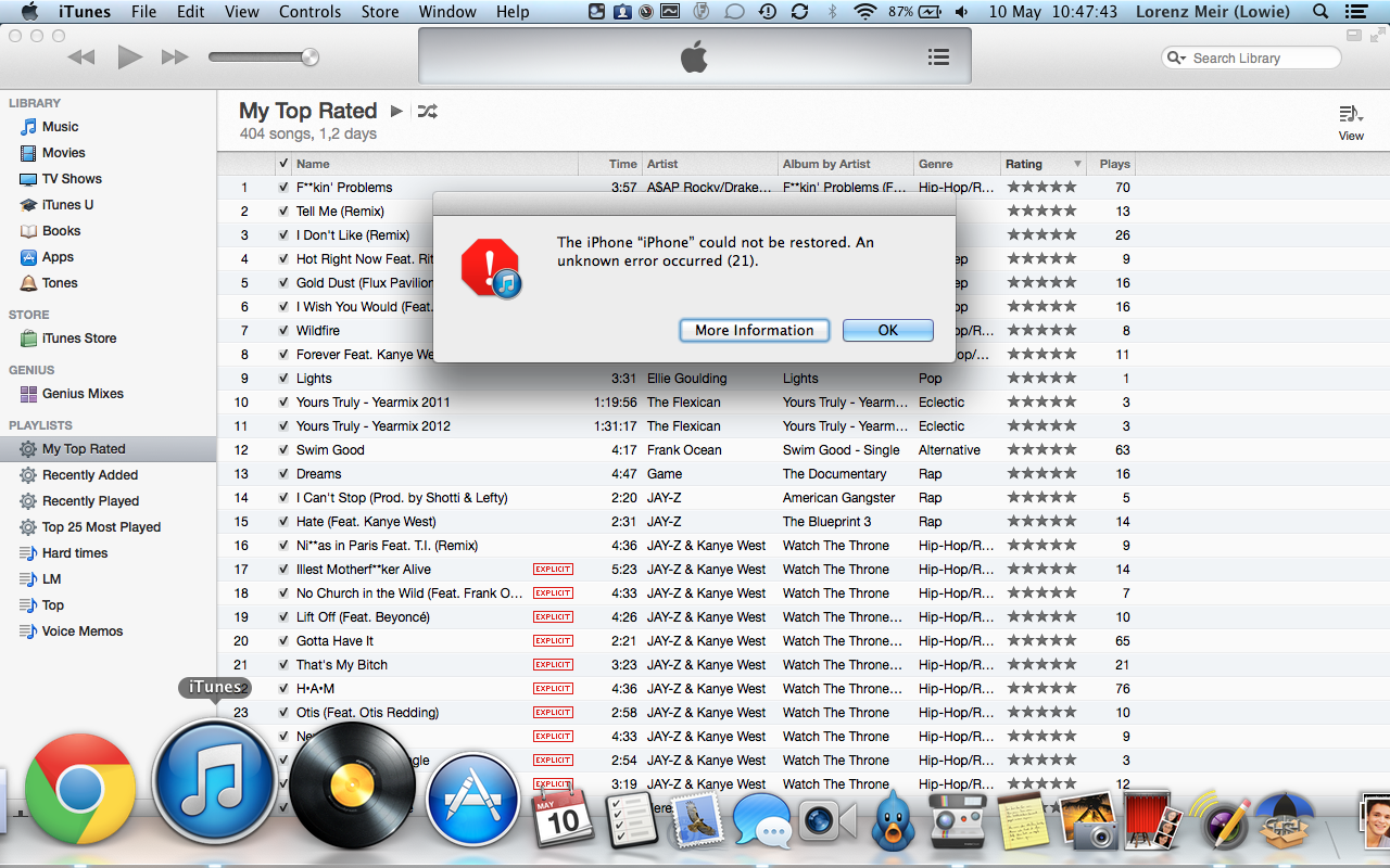

Maybe this brings new insights, I'm having new errors, error 1600 in DFU mode and error 21 in recovery mode, in normal mode it keeps flashing up the apple logo 🙂
I asked my friend about the history of the phone... It was found on the floor in a dance club and has a cracked screen. I didn't think it would affect the trouble shooting but this will likely be a problem with the motherboard? I ordered a new battery though because that could be the problem too, let's hope.

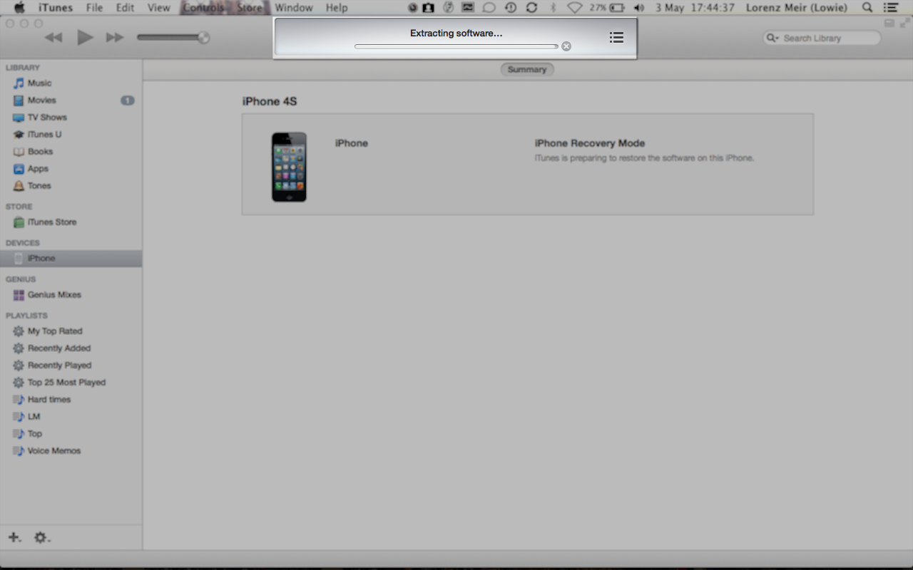

I've put in the old battery again, this causes the device to show the low battery power screen when connected to a power source but it does not charge. When I try to restore I'm getting the error 2001 back
