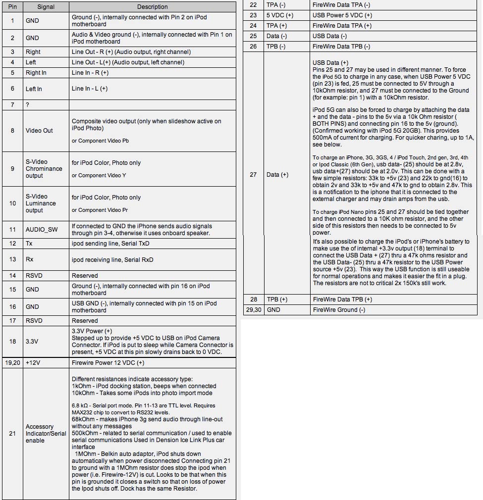

Have a good look in the dock connector with a magnifying glass/flashlight to see if pins 11 or 21 have gunk near them. That might cause them to short out (probably to the metal surrounding the connector). According to this pinout diagram, either of those will route all non-phone audio to the dock connector instead of the internal speaker)
