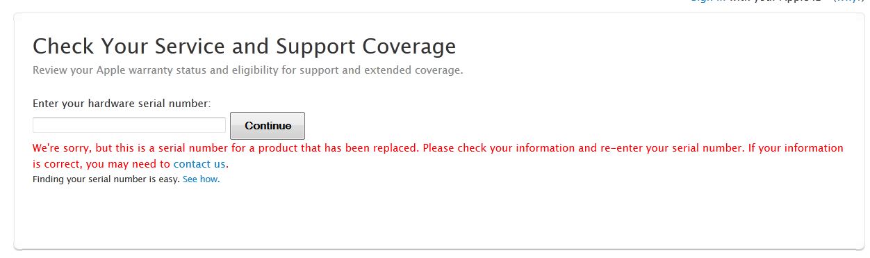

I have checked the serial number of the phone on the apple website and found out the phone had been replaced when still in warranty so I wonder what happens to iphone which have been replaced in such circumstances: As clearly itunes connects to an apple server before restoring the target, if the serial number is identified as having been already "dealt with", does this mean the phone is now as good as a brick?
Also when I connect this iphone with itune (either in recovery of DFU mode) the serial number appears as n/a in the window. Does yours show the same?

For my iphone 5, it says something along the lines of "the phone you are seeking support on has already been replaced as part of warranty", so cutting it short I cannot seek help from Apple and proceed further.
Hence my worry that eventually, when iTunes connects to the server prior to restoring the iPhone, whether it determines this is a no longer supported phone and will not do the job no matter what. There is however the fact that, in both our cases, the serial number is not reported in iTune to start with... Could that also be a clue...

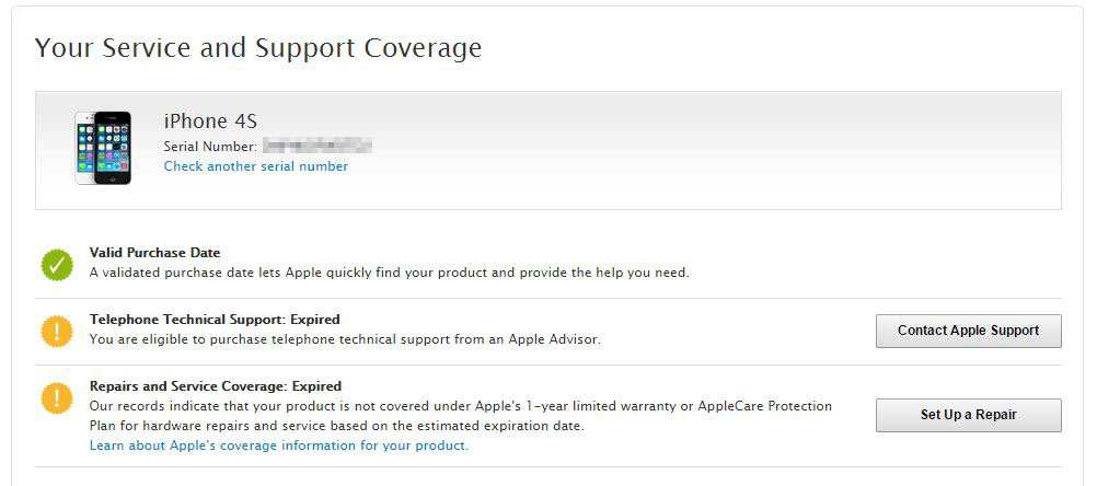

Here is what I get from the serial check :
I really don't know about Windows versions, I tried on Windows 7 and 8 again and still no luck. I also don't have access to a Mac, unfortunately.

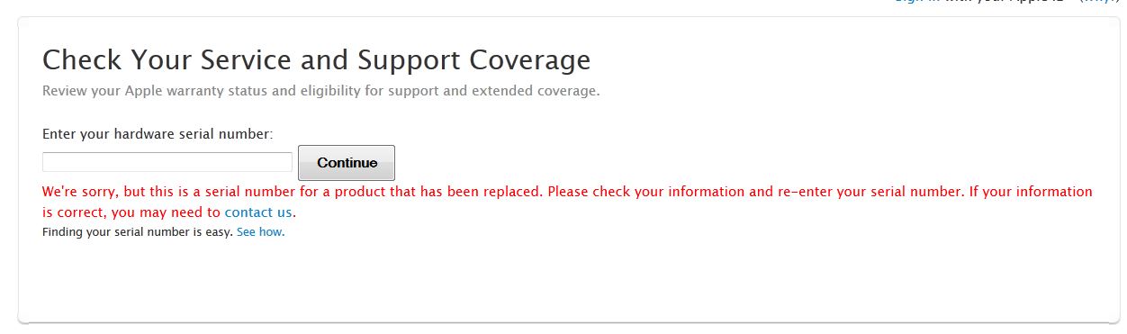

Ok tried to do the same check with mine (used this link:
https://selfsolve.apple.com/agreementWarrantyDynamic.do
and got:
(sorry pic is so small - you can click on it and it will show message clearer)

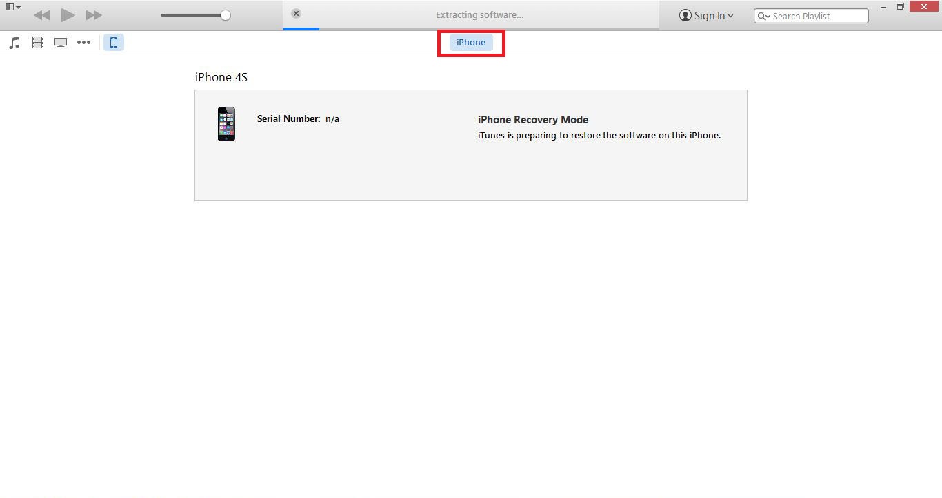

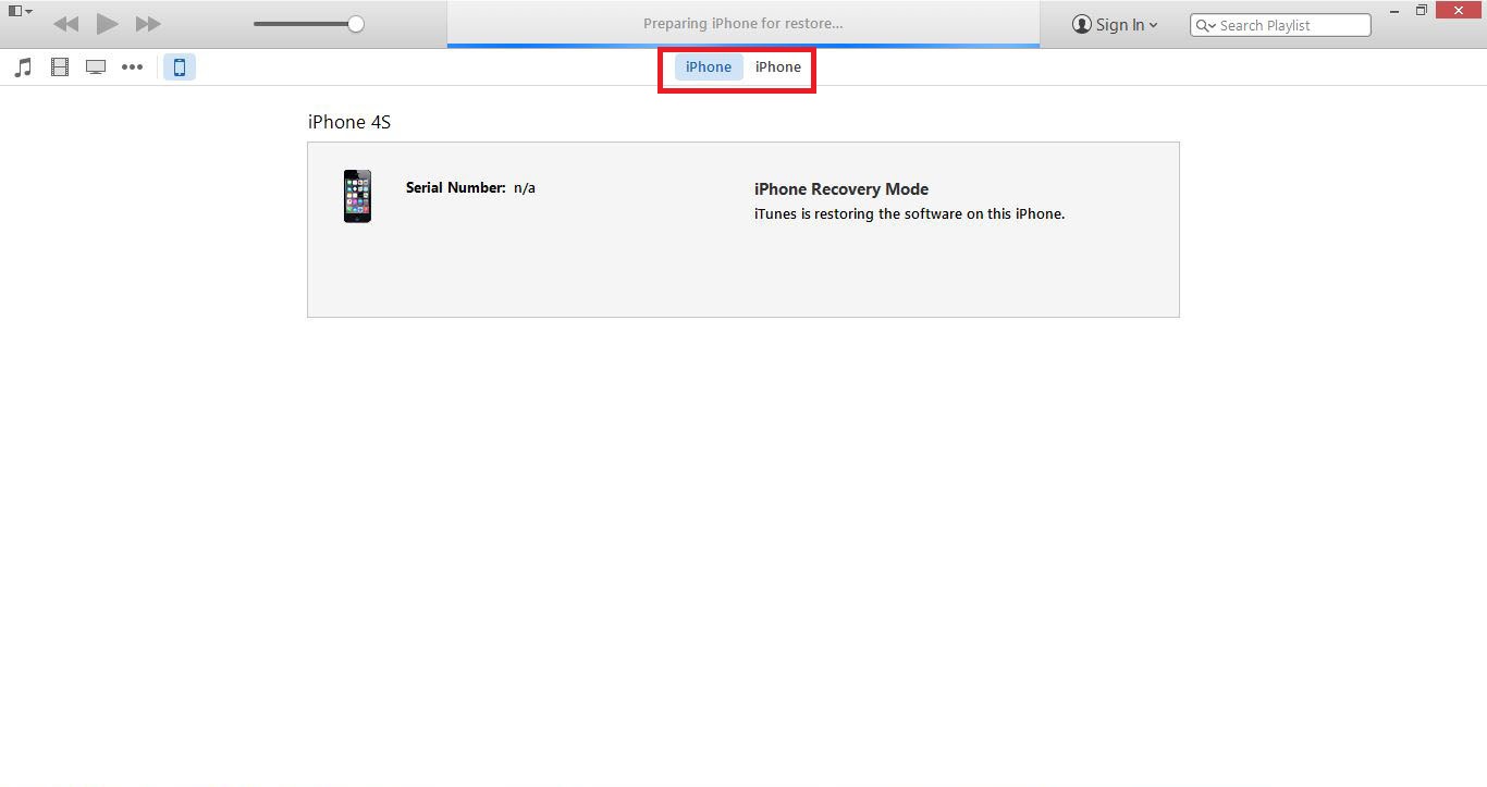

I tried one more time before giving up for today, and I could snapshot something strange in iTunes. When it's extracting the firmware, I have one iPhone detected :
But when it prepares the phone, I get this :
I can't click it as it disappears very fast, like in less than one second.
Do you have the same case?

I have tried several times now but I cannot see the same thing (ie mine only shows 1 iPhone at the top).
Tried with:
XP / itune12
XP / itune10
Win 7 / itune12
WIn 8.1 / itune12

I cannot say it's nothing, maybe it's really a hint to the problem but as you said we don't have low level monitoring available...
I'll let you know once the repair shop send me news 🙂
