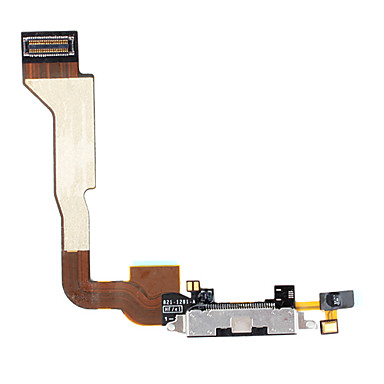

I have dealt with the same problem described here. Could not turn off my iphone 4S, it kept restarting. I had no sound controls for youtube, music, etc. No sound for new mail, new messages. After a while, randomly, the sound came back, but the battery was depleting quickly, even had 50 percent down after one night.
My problems started after my iphone 4s had fallen on a hard surface.
So I read a bunch of forums and everyone that had this problem took their's iPhones to geniuses and Apple stores and received a new iPhone. But that was not applying to me because i have no warranty anymore to my 4S.
So... i kept reading and found a topic that gave me an ideea: change the charging connector. I attached the picture of it. It's not that expensive. I even bought one charging connector, followed a tutorial on youtube and change it my self!
I had the exact same problems with my iPhone 4S after having dropped it in the snow.
At first my microphone didn't work, but a restart of the phone solved that problem.
However, the battery depleted very quickly so I first thought the battery was the problem and actually bought a new one. It was first when I was going to replace the battery that I noticed that I couldn't turn of my iPhone - it just turned back on after a couple of seconds.
I have just now replaced the charging dock port (and battery) using this Youtube guide:
https://www.youtube.com/watch?v=XGPUJTOR2b4
Took me about 30 min or so.
I can now turn off my iPhone as usual, and it stays off until I switch it back on.
I still don't know if my battery time has improved since I haven't fully charged it yet. I'll know this by tomorrow.
Thank you, twil21be, for discovering the solution to this problem!
Edit: My old charging dock port water indicator was pink, indicating that it had become wet. If that was the actual cause to the problem I'm not sure, but most likely so.
Update: Battery dropped only 3-4% during the night. Problem officially solved!
Thank you so much, twil21be. A $4 charger port on eBay saved me hundreds of dollars and lots of data along with it. I appreciate it!
