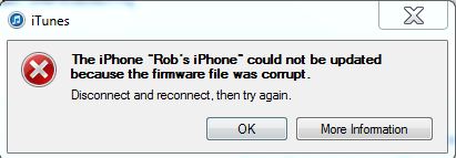

I've tried a different PC, downloaded the IPSW from Redmond Pie, through iTunes, verified Hosts file, DFU mode...nothing works and I keep getting the same error. I haven't tried an OTA update as of yet.

That error means it can't contact the Apple servers to restore. You have either messed with your hosts file, or you have ran TinyUmbrella which changes the host file.

But the error message it gave you couldn't be more clear.
The file was corrupt so you just gotta delete and redownload it.
Which I did no less than 12 times from my pc, 3 times each from another 2 pc's. I'm just as baffled as you are. I'm a jb veteran all the way back to my 3G. Thx again.

You got a badly downloaded IPSW.
The issue is on your side, either your internet connection is very choppy, bad downloader program, or just too many devices bogging your internet like microwaves, etc and making you lose wifi signal.
