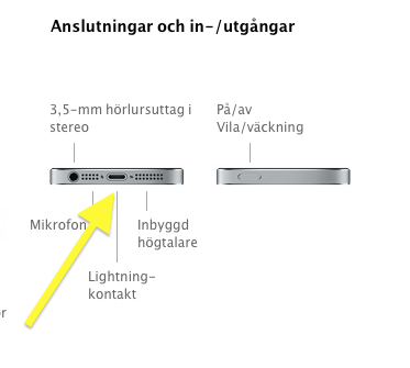

Google says the Swedish words for 'lint' are 'lint' and 'linneskav'.
See the picture for what the Lightning Port/Connector is.
Basically, if you get lint/debris in the Lightning Port/Connector of your iPhone, then when you insert the charger into that area, it may not charge (or charge well) unless you move the charger around inside the iPhone. Or it may work at a reduced rate. If you take compressed air and blow into the Lighting Port/Connector, it may remove anything that's in there (that shouldn't be in there).

Oh thats what i thought but... But you cant move the charger when its in can you?....and i dont have that at home compressed air is there any other ways?

On my iPhone 5s, the charger moves a little in the Lightning connector. Not a lot, but when I had a bunch of lint in my iPhone 5s Lightning connector, jiggling it just a little bit would cause it to switch between charging/not charging.
I've seen people post about using a wood toothpick to try and dig lint out of the Lightning connector. I took mine to the Apple Store and they cleaned it out with the compressed air.

You can try something like a toothpick carefully trying to clean inside the lightning port (as I mentioned in the other earlier thread about this).

You see.. When i plug my charger in it wont vibrate or the icon wont show up but it still charges slowly.. .. Faster when off... But cant i just blow fast in the hole lol to remove the lint ?? Stupid question i know but i did that and i used a wood toothpick before and i got a little black stuff out i dont know what but i guess its the lint and i tried to look for more but nothing else came out, do i have to try harder? And im on iOs 7.1.2

Carefully?? Lool i i broke the tooth pick when i tried cleaning it.. :(

Well, if there's nothing more that comes out (and you didn't leave any part of the toothpick inside) then there's probably not much more that you can do as far as cleaning it out. If there's still an issue, and even though I know an Apple store might not be that much of an option based on previous thread (if I recall correctly), but that's more or less what would be left for most at this point.
