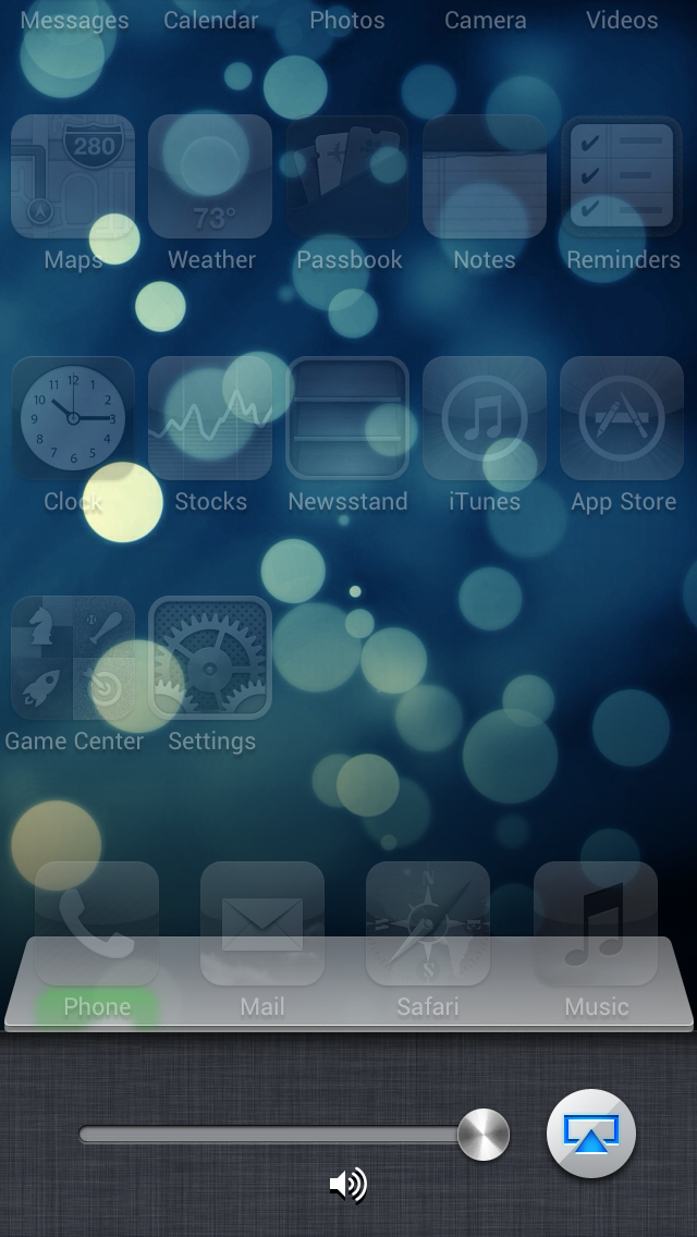

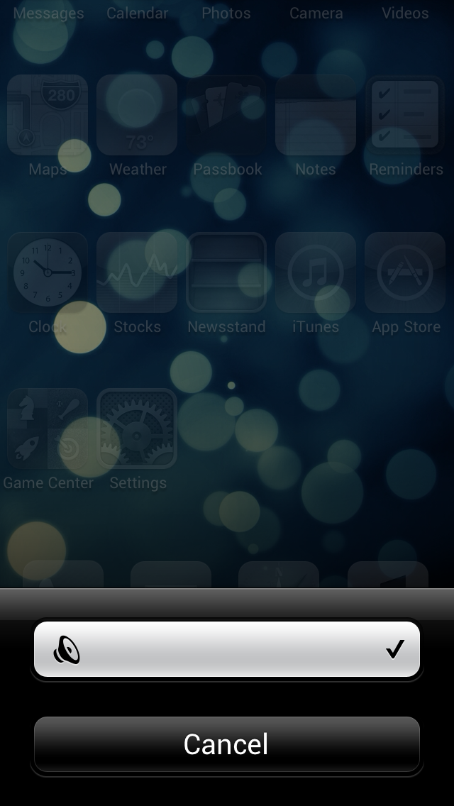

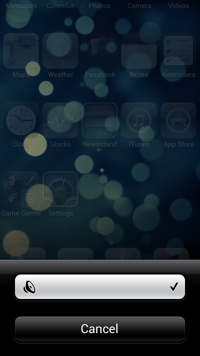

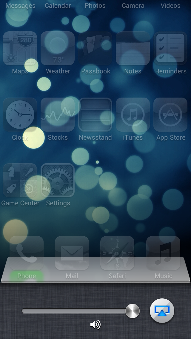

Airplay icon is there (I am not connected to anything, nor wifi), and it has no options for it. See Attached photos. This is where I think the problem could be and could be close to resolved, though I am not sure.

Airplay icon is there. Shows as if I have something connected to it. I have never used it, accept and has no devices listed:

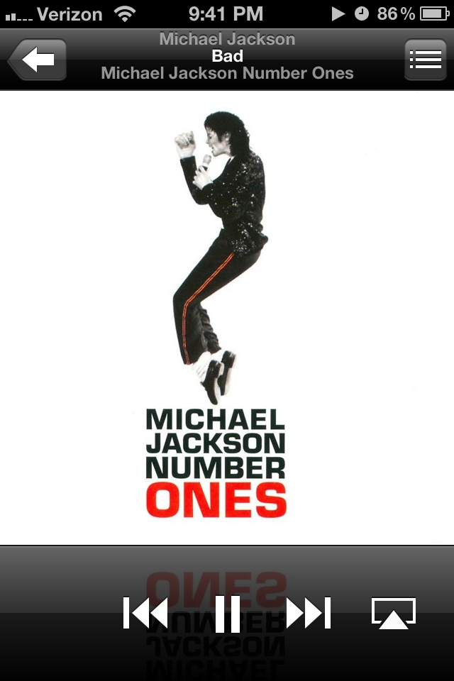

I've had a similar issue with my iPhone 5 where I get no sound from any app or notification. My phone says it's connected to something via airplay even though it wasn't. I read that it might have something to do with a cheap lightning cable/plug but I can't say for sure.
To fix the issue I do a hard reboot by holding down the power and home button until the phone turns off and the Apple logo reappears. Then everything works as normal again.
EDIT: If that doesn't work, a google search for "iphone no sound dock connector" may or may not give you some useful information.

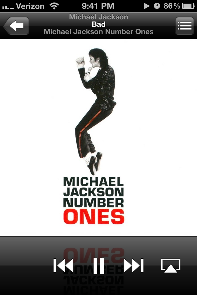

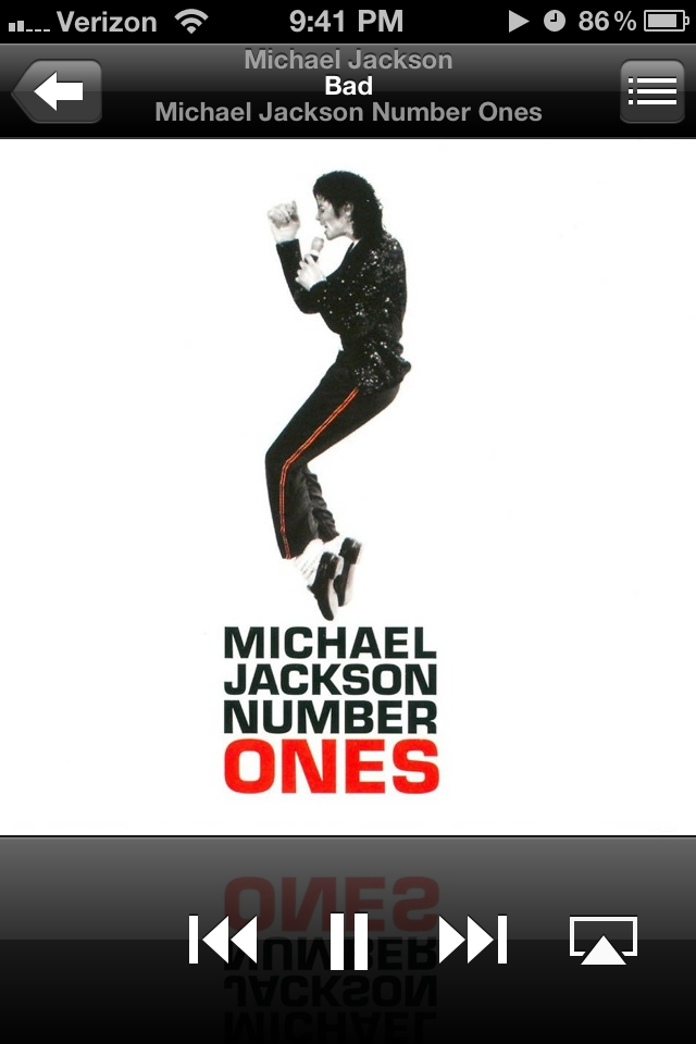

I was thinking that if it was a usual issue with a dock, it might show up as
this photo suggests:
This photo is from: https://forums.macrumors.com/threads/1372660/

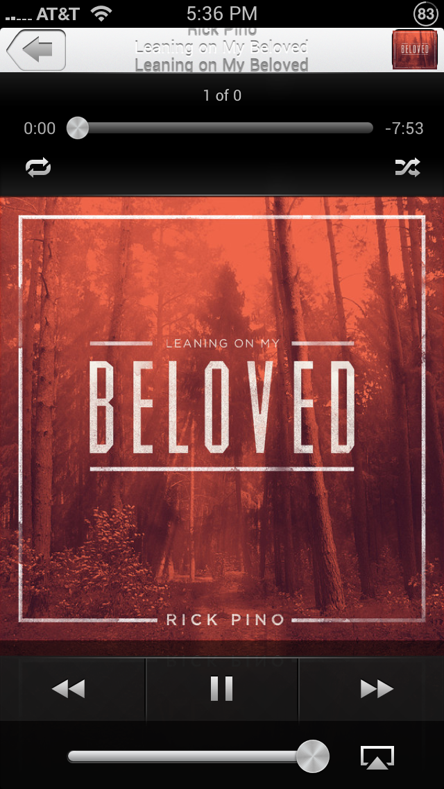

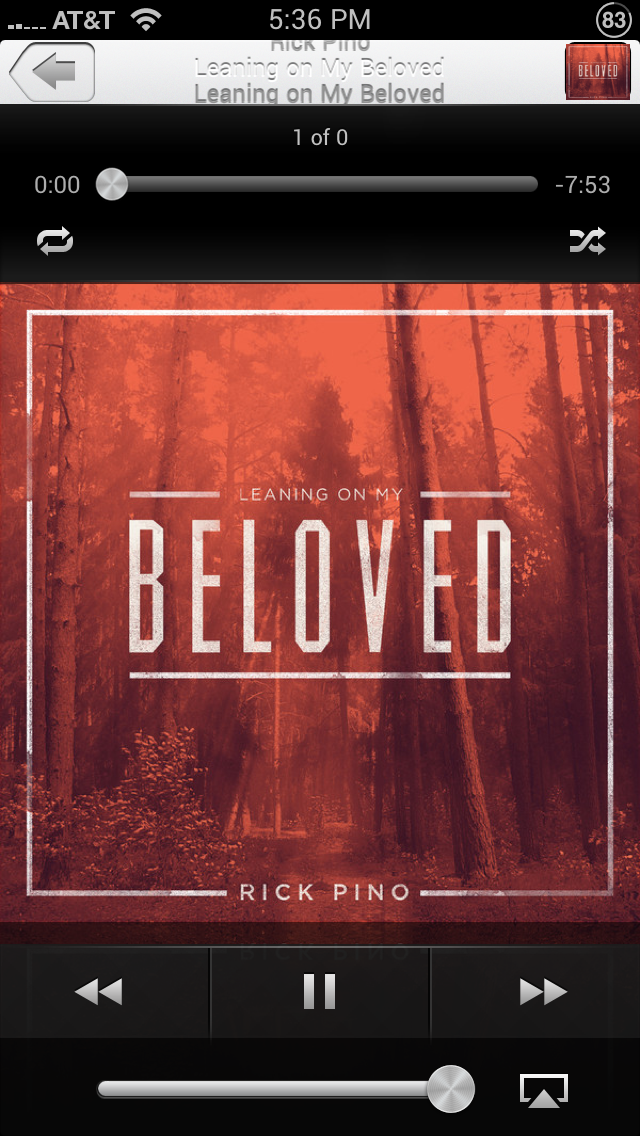

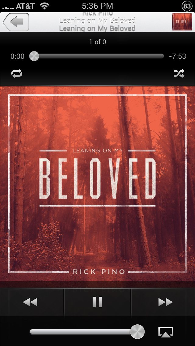

Mine shows all the controls:
Anyway, I digress:
I was thinking if it had to do with a dock, I would have been using wifi, airplay or a dock of some sort. Music does not even play, with the time showing, when a song is selected, it goes to the song and immediately cuts off- no playback time. Videos do not play. Not playing with no sound, they don't play at all. The issues occurred right after what could have been a tweak crash. My phone rebooted- or did a respring- not connected to anything, I think, and then these problems occurred.
Anyway, I digress:
