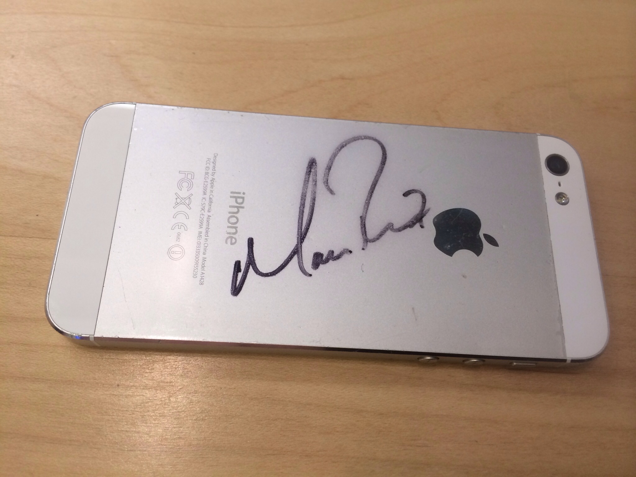

Finally made it back to the Apple store yesterday and they were miffed by it not showing a serial number. Immediate unit swap and my signed iPhone was handed over. Oh well I have the video of it being signed ... pics ... and the memory of it signed.
In the end Apple is an awesome company with awesome products that they stand behind and an awesome team that tries to accommodate their customers.
A pic of the back of the iPhone
