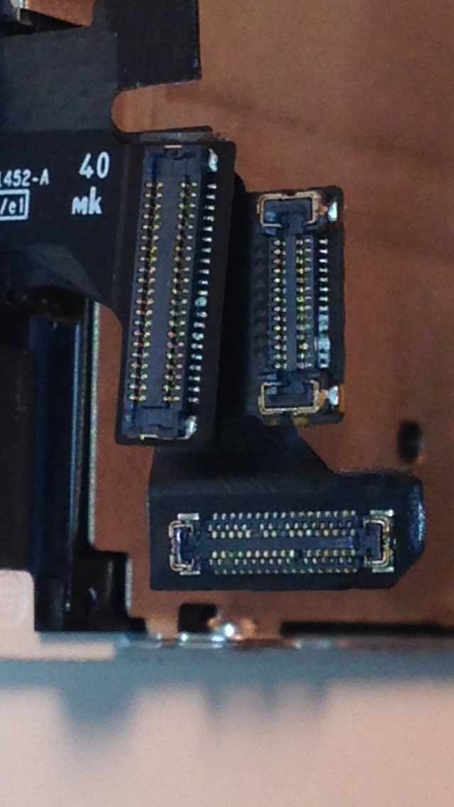

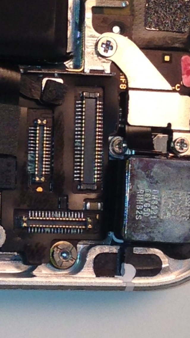

Since I recently replaced the screen and battery of my own iPhone 5, I was curious to if I could fix this one as well. Before ordering a new screen I went ahead and looked inside the phone to check if any cables were disconnected or whatnot. Unfortunately, when I disconnected the screen, the connectors on the logic board and the screen looked as if they were missing some pins, and that some sort of reaction has caused a green (liquid?) to cover some of the pins. The same green color was also found on the part just below the connectors on the logic board (see photos, if blurry, it's because they were taken with my iPhone 5 using its magnifier mode).
My initial thought is that this phone is done for, and replacing the screen will have no effect, is this correct? Also, is there a way to back it up before I in that case recycle it? When I tried accessing it through iTunes it said it was locked by Find My iPhone being turned on.

Corrosion.. You can try to clean those pins off but, if they’re missing your only option is to replace the terminal on the board.. You can always sell it as a parts phone.

The connectors on the logic board don't look too bad. Clean them with IPA (>90%) and a soft brush. Let them air dry and them inspect them under magnification. What can happen, when there is localized corrosion like this, is that the solder connection gets eaten away. Sometime a light touch-up with a fine point soldering iron will fix it, other times the connector needs to be replaced. I wouldn't say this is DIY, as the density on those boards is quite high and everything is so tiny but an experienced micro-solderer can do this no problems. The connectors on the screen assembly are more damaged so you'll have to replace the screen.
Putting a water damaged phone in rice is, sadly, a persistent myth. The rice does nothing other than let the water fester and corrode. This phone may actually be salvageable.

Thank you for the reply, the water damage seem to be more than just the screen connectors though, I tried repairing the OS through iTunes and all I get is error messages, which lead me to believe the corrosion has spread to other parts as well.
