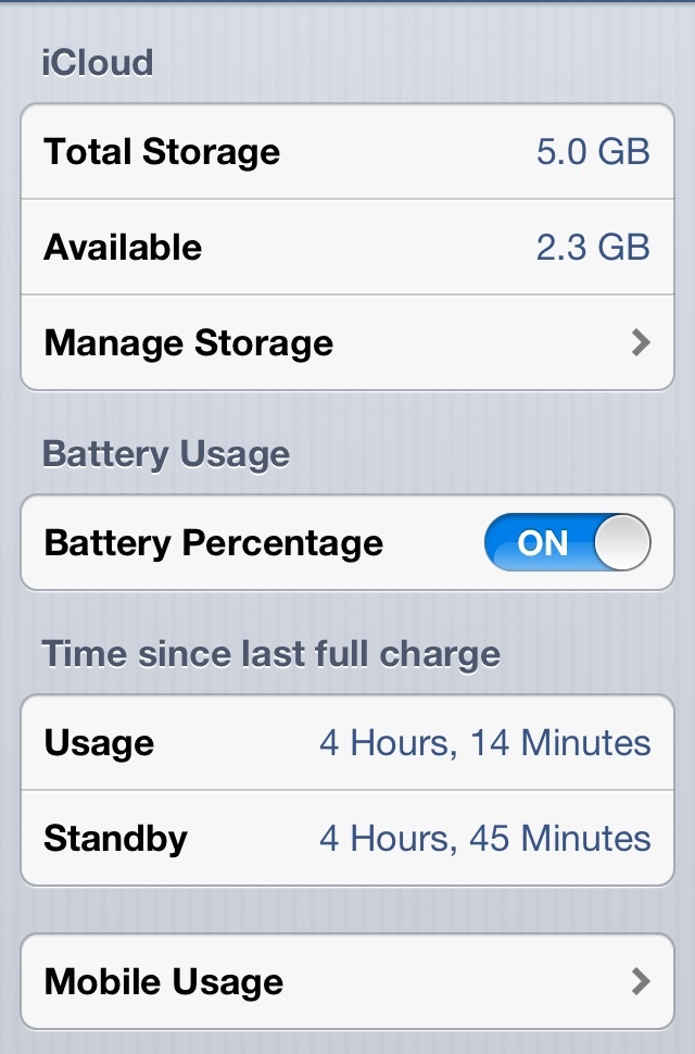

4 hours of usage and 4 hours of standby... donno how that's possible
from my understanding ( i didnt get it either) users on here told me that stand by includes the total time since unpluged. not sure i assumed standby would only be time its not being used.
Whenever I see stats that show usage is almost equal to standby AND you haven't been using the phone the whole time....it's usually a bad app that's still running.
Kill all your apps and restart the phone just to be sure.

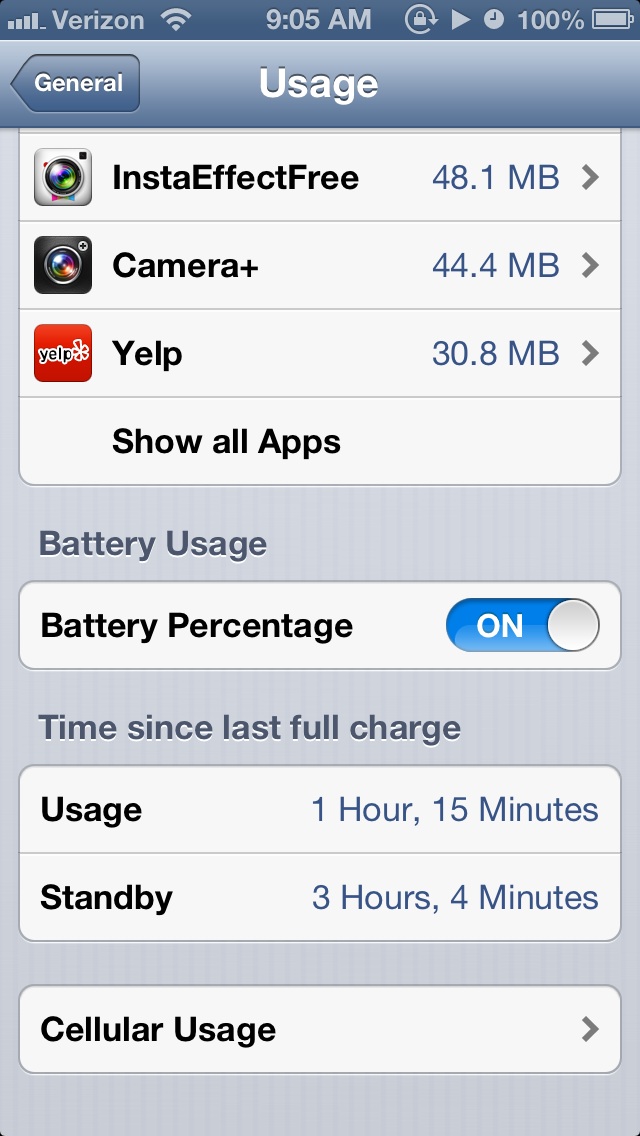

I thought I was doing well until I saw Dave's. I'm happy with this though. Not much in terms of usage, but the OP cited standby concerns and I'm fortunate enough not to have the same issue. Solid LTE here though.

That's awful. This is how my battery has been faring this morning, and this is very typical results for me. Get a replacement.

Yeah...this seems a little too good.
I notice from the shot you likely don't have iCloud setup? Is that true?
-Kevin
