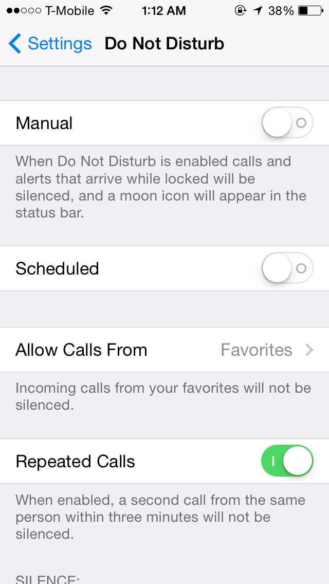

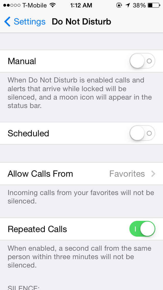

Try this: Go to 'settings' and select "do not disturb" then turn off the switch for "Repeated Calls" - I had the same issue and after turning off the Repeated Calls toggle the problem stopped. Hope this helps you.🙂
You are saying that somehow a completely unrelated function of repeated calls related to another unrelated feature of do not disturb affected getting audible notifications of text messages?
