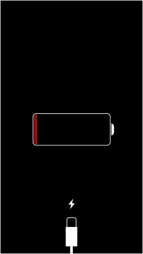

I have an iPhone 5, 32GB.
I was about to make a phone call on 8% battery and before I could press the call button, the phone died. This has happened before several times - I was not surprised.
However, when I plug in the iPhone to a wall adapter, the screens turns on with a red battery and lighting cable icon below it (see picture). The screen turns on and off every 10 seconds or so.
I thought that this screen mean the iPhone is charging. But it has now been an hour and the phone is still showing this screen. It is also worth mentioning that I am jailbroken on iOS 8.x.x (forget the exact version, but it is one of the later iOS 8's).
Can anybody help me? Please and thank you.
Also, even when unplugged and I try to turn the phone on, the same screen with the lighting cable/battery icon shows up...

Usually this is a bad connection issue caused by crap (technical term) in your charging port.

Okay. So now I have an Apple USB connecting it to my Macbook Pro. If I hold it at a certain angle so not to disrupt the USB-iPhone connection, the lighting bolt under the battery goes away. Does this mean it is charging?
UPDATE: As I am typing this, the Apple Logo just showed up and the iPhone just vibrated, iTunes recognizes it, and it is turned on!!
NOW.... how do I avoid this in the future? Will the $30+ Apple iPhone charger guarantee this doesn't happen again? I will buy one if so! Should I still look into cleaning the charging port with compressed air?
Dodgy charger and dirty port are the two common non charging issues that pop up.

Which end of the cable are you 'holding at a special angle'? If it's the phone end then it's not the power brick that's your issue. If it is the brick end then I would buy a 10/12w iPad charger personally as they are universal anyway.

Uh-oh... it's the iPhone end that causes trouble. Perhaps cleaning the port with compressed air will help a bit with that?
you iPhone 5 battery may need replacing.

It probably does need replacing. The battery suddenly jumps from the mid twenties to anything below 15%. Once I hit 15% it turns off within an hour. Oh, and whenever I take a picture with the battery below 25%, I see a massive battery drain especially when I don't close the camera app in multitasking.
Try a different cable

From your answer... Have the battery replaced and your problems will go.
There is actually a batch of iPhone 5 with bad battery that Apple acknowledges

So if its just the port that needs to be cleaned, walk into an Apple store and ask them. I have had them do it for me multiple times - the genius guys dont even log in a ticket. Its totally possible that I got lucky but I havent used Apple care - just walked in, looked confused and they have done it in 30 seconds. 🙂

See the other thread in this section about pocket fluff....easy to clean the port out yourself and not always a great idea to use compressed air as it could blow the fluff inside the phone instead of out. Better to use something to have a prod inside and pull it out.
I had a similar issue, cleaned it out and worked fine since. I used a straightened paper clip which probably isnt the best thing to use but it worked and my phone survived!
A drop of WD-40 works wonders for dirty ports on various devices, including my Garmin 510.
Power off the phone and hold upright. spray a drop onto the charging tip and insert into the phone and remove several times, wiping on a cloth or tissue paper. Give the port several minutes to dry before turning on.
I was able to revive an iPhone 5 that I found on a hillside that had been there for several months. It would not take a charge. The WD-40 worked to clean out the port, which had a fair bit of encrusted dirt inside.
