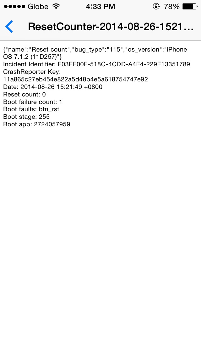

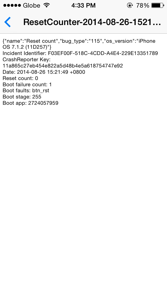

Does this look good?

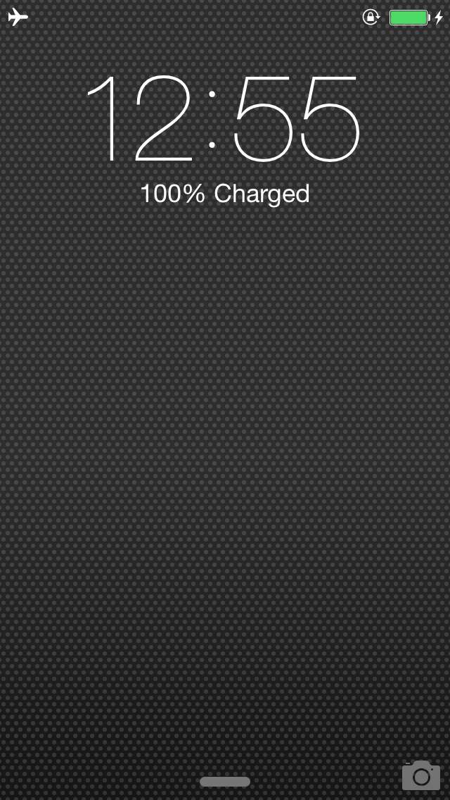

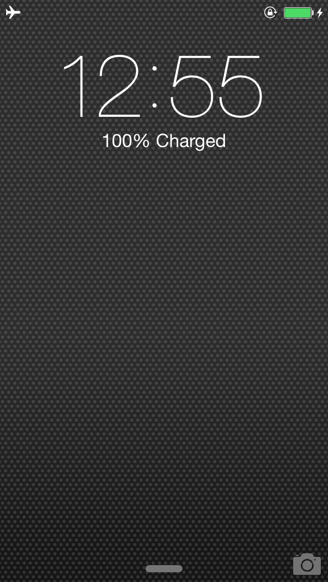

I had it checked using the diagnostic test link and the Apple CSR said there aren't any hardware problems. I also never get the fully charged sign even on 100% battery. It's always this flash sign beside the battery icon. Is it a bug?
The charging lightning bolt symbol by the battery in the status bar is always the same when the phone is plugged in, it doesn't change when the phone is charging or fully charged as of iOS 7.
