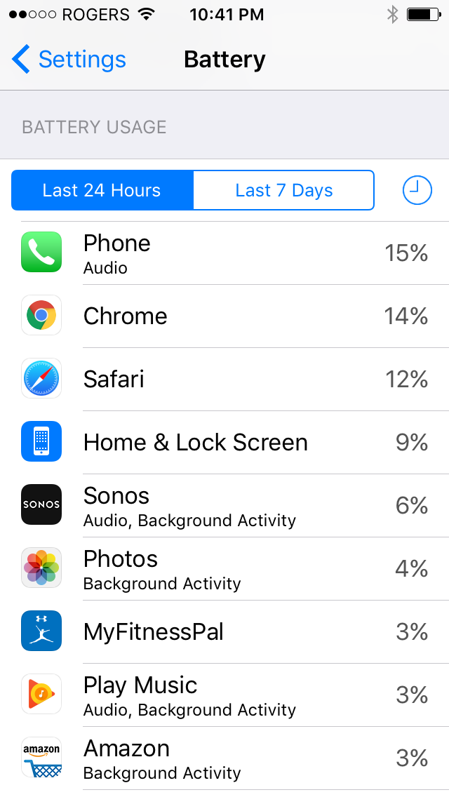

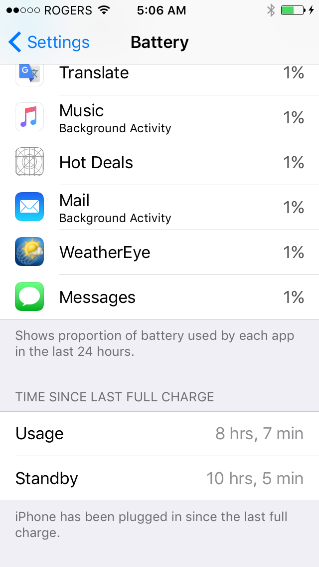

Thanks for the reply C DM.
I am not doing anything that unusual with my iPhone. I have also noted that on few occasions, my phone would shut down when there's still around 20-30% battery left and the only way to turn it on is through hard reset. It happened today.
I am just doing the basic stuff with my phone, but it is only now that I notice that my battery drains too fast.
Here is a screenshot of my usage.
Should I just change the battery? Would really like to know myself if another issue might be at fault...

If the phone is dying when the battery is still showing something like 20-30% that does sound a bit more like it's probably more on the battery not being as good anymore vs. something else. But are you saying it turns off in that case, or gets stuck in some state where you can't even turn it on and only a hard reset works (in which case that might be more along the lines of the device crashing and getting stuck in a weird state). Seems like contacting Apple about it might be worth a shot to see if they can run a diagnostic on the battery.

The easiest way to see if the battery is the issue is to test the battery with an application like coconutBattery if you have a mac or 3uTools if you have a windows computer. Download the program, connect your phone to the computer and look at the battery informations. Specifically, look for the Design Capacity. That will tell you how much of the battery's theoretical design capacity is available for use (as opposed to charge state). If your design capacity is lower than 70%, then a change is in order. Batteries that are really weak, typically have a design capacity of <50%.
As a reference point, Apple warranties their batteries in the first year of the device to maintain a design capacity of >80%. For your 4 year old battery, I suspect the DC is quite low.

Just to post an update:
I went to an Apple store to the Genius Bar. The clerk did a battery health check for my iPhone 5s. Apparently, my battery is still going strong and it is at 88%, which he said is quite good for a 4 year old phone. I also had a very small number of charging cycles. He also recommended me to do a fresh iTunes restore, which will supposedly decrease my battery drainage. I guess my issues are not that bad. However, it is strange that sometimes my phone will show the battery status at 2%, and then would suddenly jump to 24% right after plugging it.
In any case, I have decided not to install a fresh battery for the moment. I will most likely get an iPhone 7/8 during the holiday season when the prices should drop.
