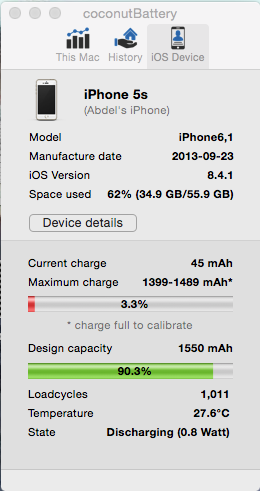

This is what I got for my iPhone battery details when using coconut battery
Is the load cycle too high? Seems like based on the numbers, the battery can still hold a charge almost the same as new
