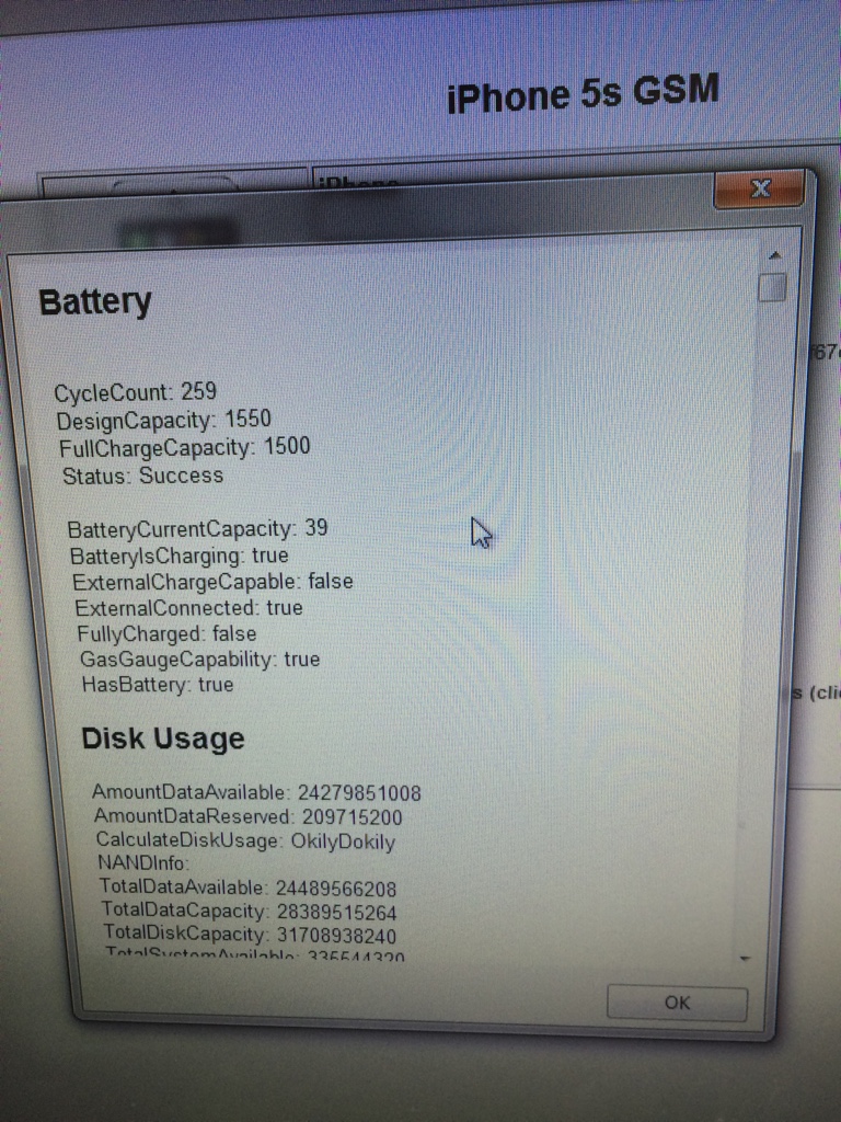

Issue was before update to ios 9, may do ibackupbot before going to Apple. Just randomly started draining, was getting hot when I restored. Charging for 4 hours, cool to touch so that's good. No service currently, wanted to do testing before activating. Airplane mode on

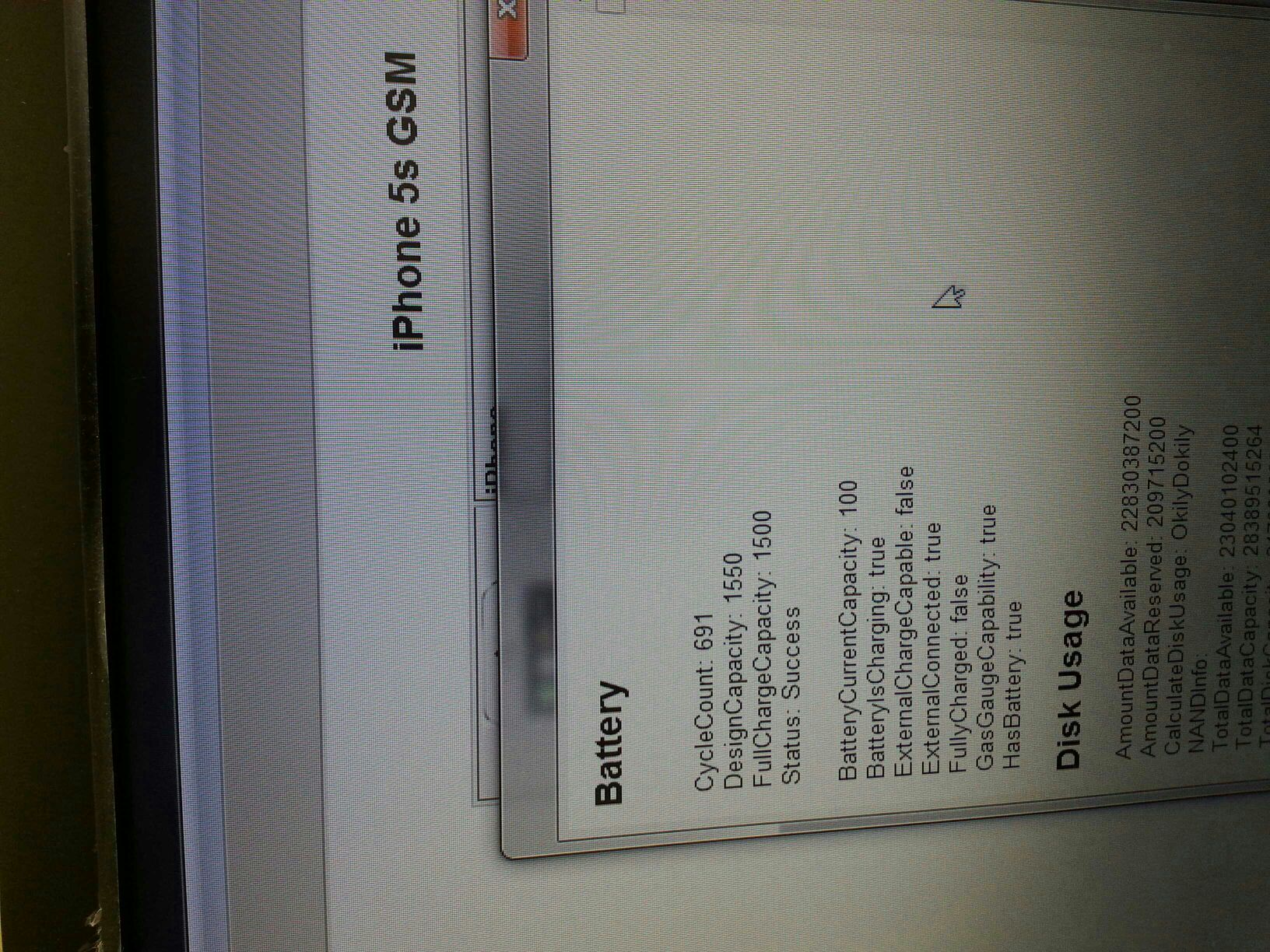

Battery Doc, not Battery Doctor, offers health and cycle count. I believe its 1.99 on the app store. If you have a Mac, you can download Coconut Battery (Google it, not on Mac App Store) and it gives you this same information for free.
As far as Apple is concerned, you have a perfect Battery. They will not even consider replacing it.
