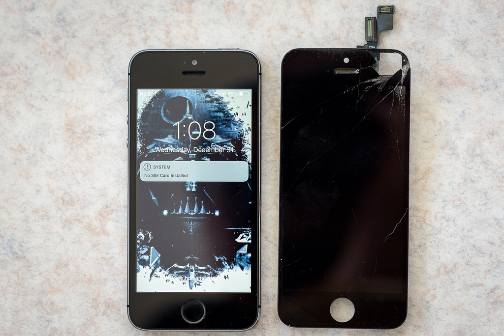

Finally got the courage to work on replacing the screen. I didn't review all of the fixit step by step instructions before ordering a new screen, so I didn't get an iOpener for removing the front facing camera and sensor cable. Instead, I used a sock filled with some rice and it worked just as good. Anyway, everything is working good on the phone so far.
Never mind about the date. I forgot to connect it to our wifi network before taking the photo.
Nice Job!
