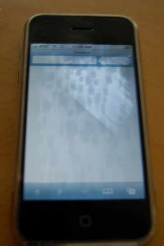

i have an iPhone 5s a weird problem came out i was trying to update to ios8 iTunes restore error 12 i have searched it's about battery after i have changed the battery and the screen came like this recently i have tried restoring the phone again iTunes error 9 and stuck in recovery mode
please could someone help how to fix this problem
