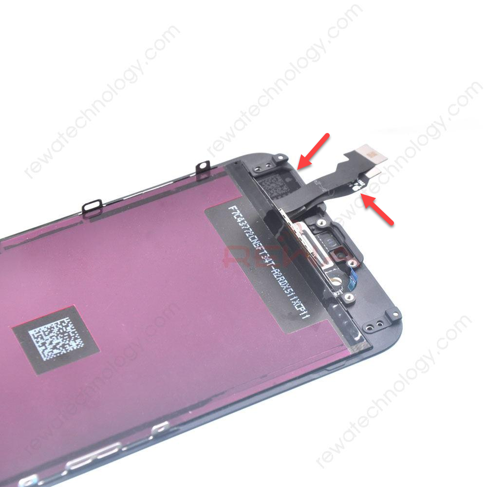

Hi there, my iPhone 6, bought day one of availability has been going strong for me until February of this year. about 4.5 years old! The battery finally gave out on me so I went to a local mom and pop to have the battery replaced (im a 3 hour drive from the nearest apple store). The fellow swapped out the battery but discovered he broke the display ribbon cable in the process. He offered to replace the screen, and I accepted. But as soon as I got the iPhone 6 back I noticed right away the colors were quite washed out. I then quickly noticed that the screen blacks out when wearing my polarized sun glasses (I wear the sun glasses daily and look at my iPhone with them on all the time). And I later noticed that the new screen is thicker than the original so its not flush with the metal case of the phone. The viewing angle is also less with this screen, so I've noticed when I have my phone sitting on my desk, I have to change my position to properly view it (which wasnt a problem before). So it looks like this is a cheaper TN panel compared to the OEM IPS display.
When looking for replacement screens, how can I identify that a replacement is an authentic match to the higher quality IPS display on my iPhone 6? I want to find the proper display before I have the fellow replace it.
Thanks
You will find the Apple logo silk screened on the flex cable and the display assembly.
