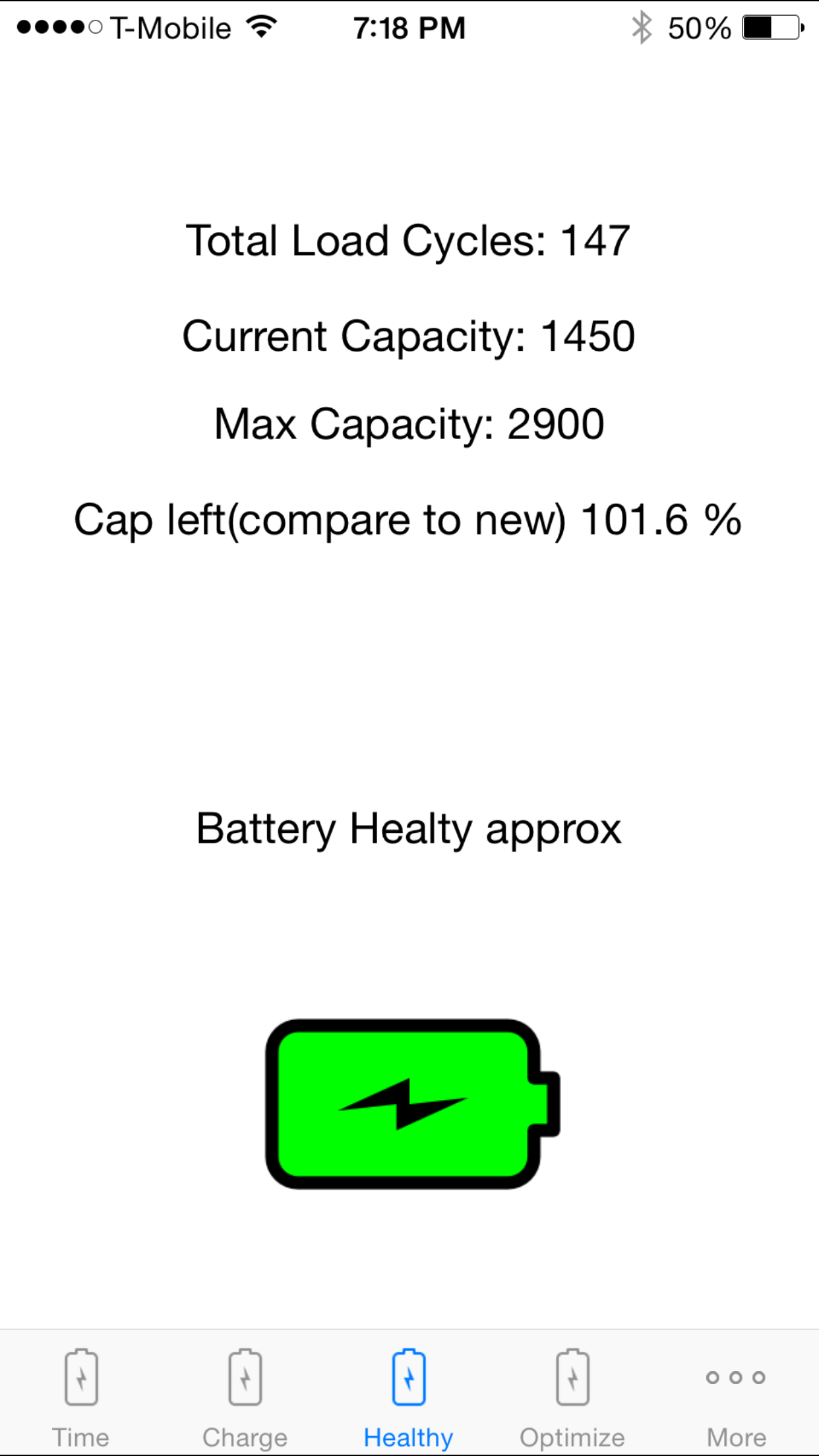

Does this look good?

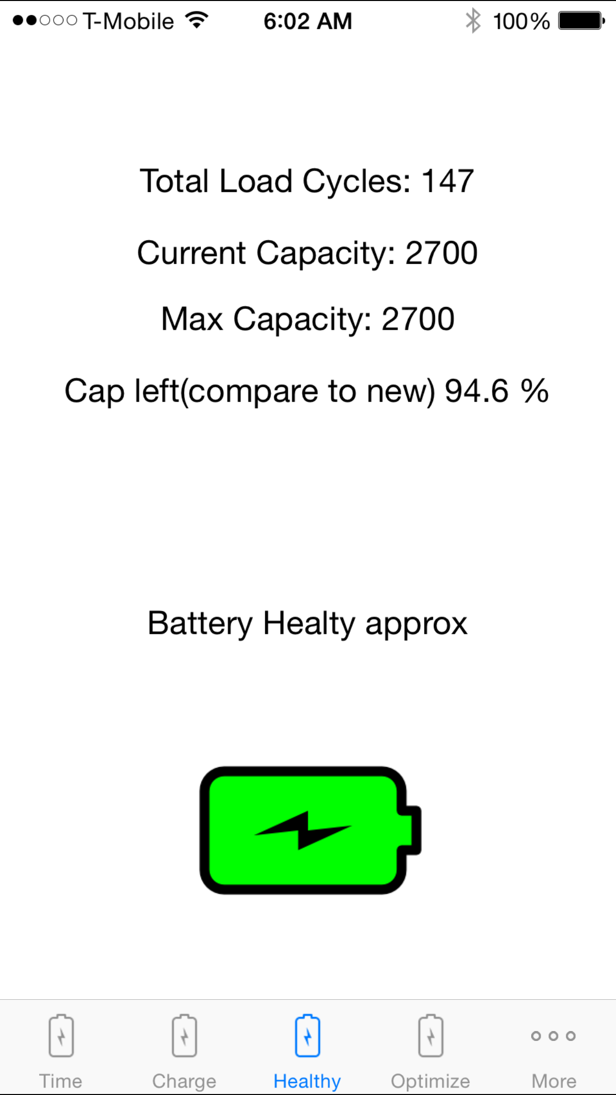

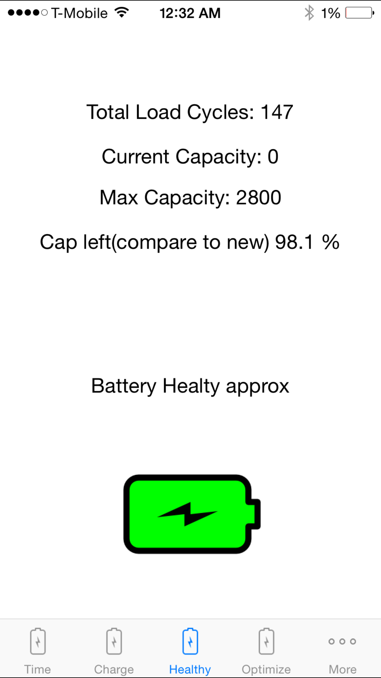

You guys have been such a great help! I let it die last night! I took two screen shots, one before it died, and one after it charge for about 6 hours. and then unplugged it.
I can see the max capacity went down both times. Is it still ok?
Not sure about that. The app seems a little off since the last update. The 2700/2700 suggests that the battery is as good as new, which is should be with so few charge cycles.
I thought the app maybe acting up. It didn't even add another cycle count. Is this normal?
