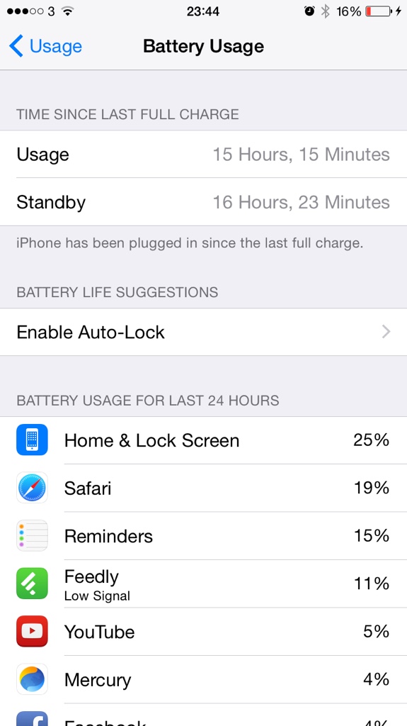

ImageUploadedByTapatalk1426204099.338424.jpgthe standby and usage time are still weird with clean install of 8.2. Usage is massively wrong. It was sat on the desk with screen locked for 7 solid hours out of the 16 hours 23 minutes. ImageUploadedByTapatalk1426204099.338424.jpg

If you had done a full restore by wiping the phone and NOT reinstalling any apps / signing in to anything, the usage times should not be that.

The only thing I have not done is wiped the phone and not install any apps for the day. The closest was a clean install and I installed 10 apps or so, but not Facebook or google hangouts.
