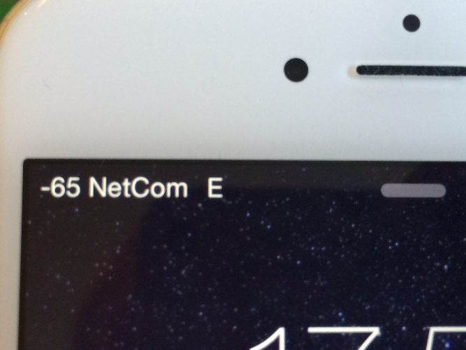

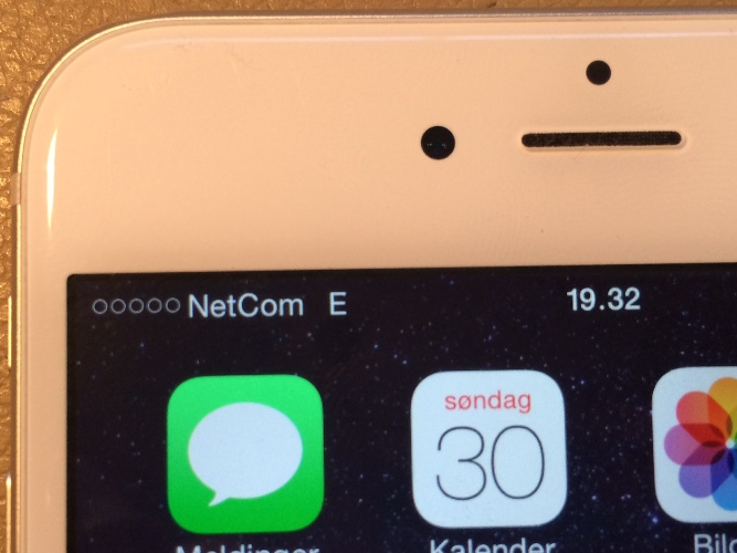

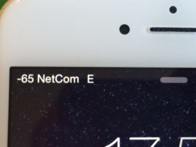

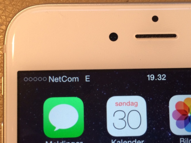

Hi,
I have a problem with a iPhone 6 Plus.
On a scale that goes from -140 to -40 (best signal possible is -40), the phone shows -65 dB. This is a strong signal. But the signal-bars doesn't show up.
Cellular data works fine, but SMS and calls doesn't work. If I reinsert the SIM, it shows the bars, but as soon as I try to call from the phone, call to the phone, or send a text message, the bars dissapear.
I've tried to connect to 2G, 3G and 4G. I've tried to reset network-settings, and tried another SIM-card. The phone is not jailbreaked. I've also tried to set up the phone as new.
Someone that have any tips for what I can try next?
Thanks in advance!

Thanks for your answear. In Norway its 5 years because of the Norwegian law. But the battery wouldn't take charge because of water damage to the charge-plug. The water did not reach the motherboard, only the Lightning-plug. After battery-change, the phone is charging. The battery is original, but the replacement is not done by Apple, and with the water dammage in mind too, I'm afraid it's no guarantee. I can try to change the lightning-flex where the antenna-cable goes, but I only have flex to iPhone 6 left, not 6 Plus, and I dont believe a change would work, because the phone HAS a lot of signal. It just doesn't know how to use it to other than cellular data.
Pay for a replacement and next time keep
It away from water.
And obviously the water did reach the motherboard or you wouldn't have all these issues if it didn't.
