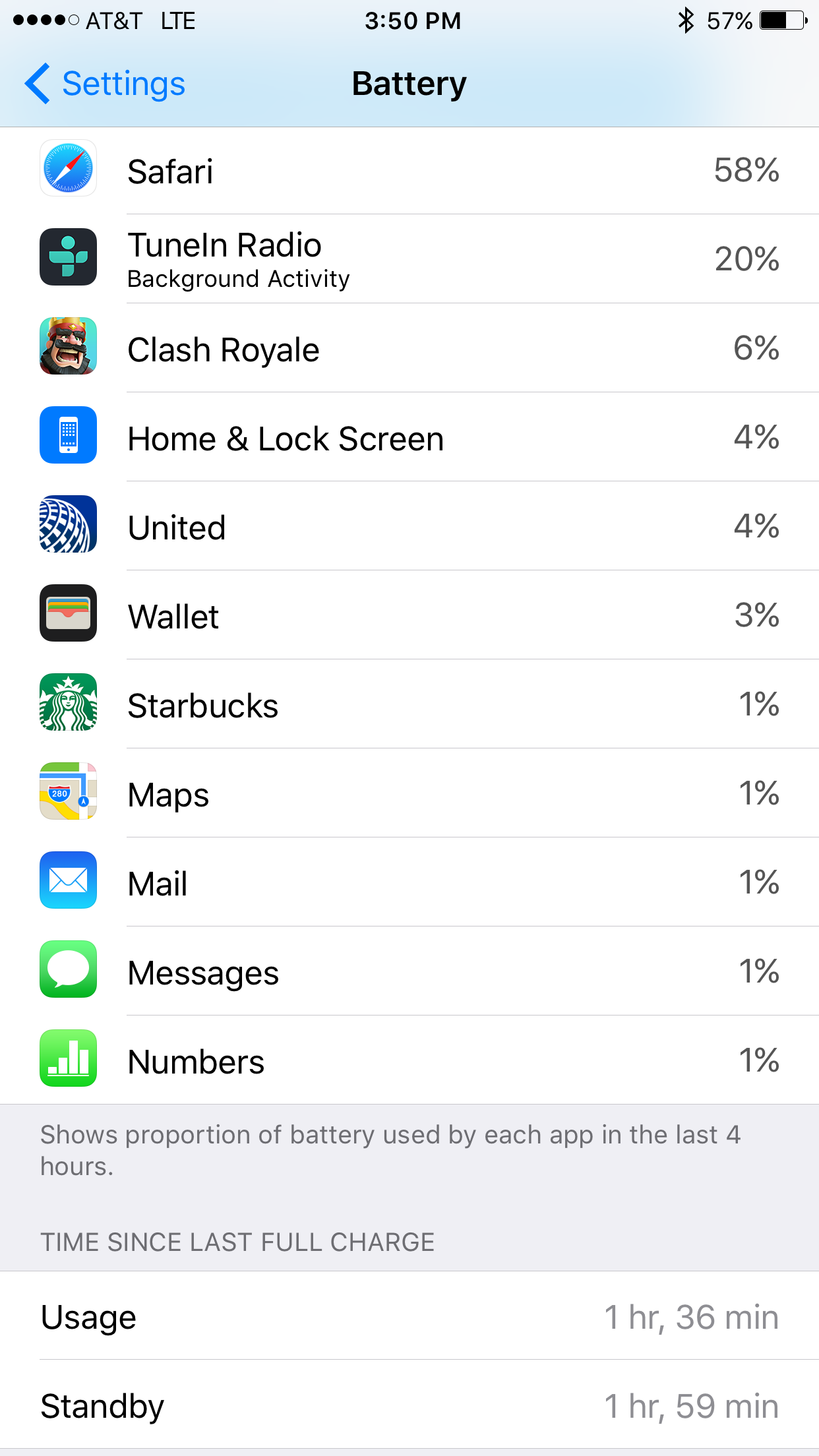

Does this seem right to you?
96 minutes of macrumors and I'm st 57% battery?

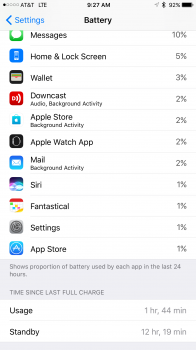

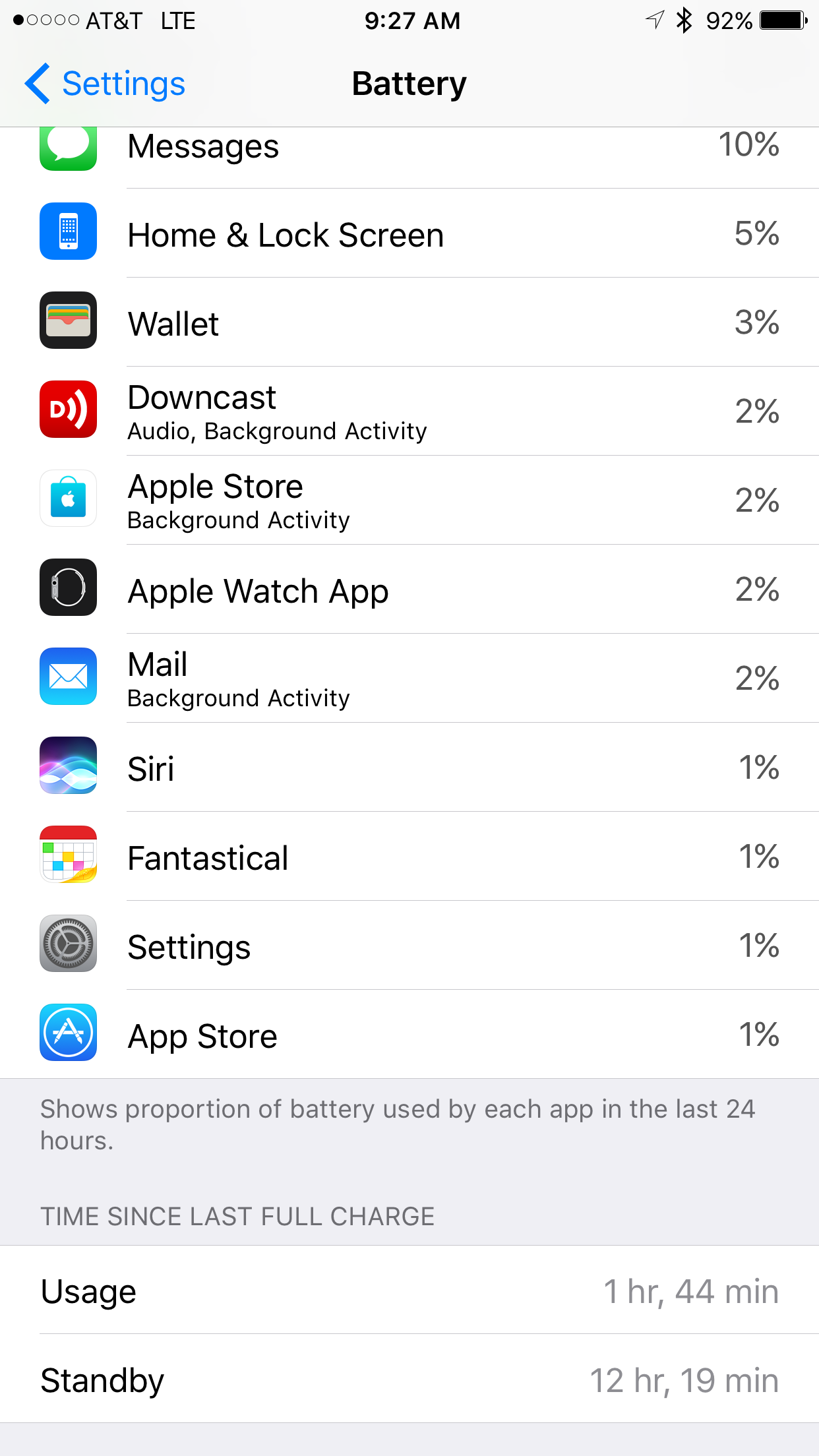

Got my new battery installed. I opted to do that instead of buying a new phone. Look at the stats now.
Yeah it was definitely a failing battery. Glad that it is all worked out!
This is not right, you should get around 8 hours of light to regular use out of an iPhone 6 plus battery, can I ask how old is the iPhone?
It was probably over 500 cycles as the replacement battery has gotten the OP 800X more battery life.
This is not right, you should get around 8 hours of light to regular use out of an iPhone 6S battery, can I ask how old is the iPhone?
Have you checked to see what apps are running, sometimes if you have apps running in the background this will decrease your battery last time.
It's a launch day 6 plus. I received it in September of 2014. This is the kind of battery life I was getting back then. It's nice to have "my old phone back".
