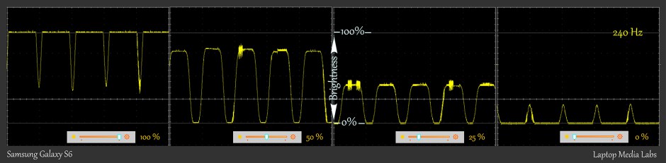

The culprit is quite simple; pwm. For many people the brightness of these new screens is becoming a bit much, most people can simply correct the issue by dimming, or using a filter like f.lux or night shade. For some people though, this doesn't do ****. The reason is Pulse Width Modulation. Turns out that some people's eyes can detect the flicker of the pwm display which makes the ciliary muscle go ape **** trying to focus with each flicker. True story. Many led displays operate via pwm. What that means is that when a screen is at maximum brightness, the individual pixels are transmitting *almost* continuous light. When you dim the screen, it doesn't simply reduce the voltage and thus render a dimmer image; what actually happens is that the off cycle is increased relative to the on cycle. ie. the valley's become wider in between the peak/plateau.
This is pwm. And pwm is a right nasty git... It trashed my vision, probably permanently. Now, if everything in the world is going LED, you're screwed right? Ish. PWM is a common technology on lower end screens, no matter how nice you think your device is, the reality is that the actual quality of that screen is much lower on these tiny devices than many larger, more expensive offerings such as TV's and large monitors. LED light bulbs are no different, some use pwm and some don't. Yay homework. After the Galaxy S6 I stepped into a iPhone 6S+, hoping my earlier comfort with the iPhone 4s screen would carry over.

I've included a link to a exceptionally technical review of the S6. I know this is a mac forum however it illustrates the pwm principles in play and offers digestible graphs. Point is, every hardware manufacturer out there knows explicitly whether they are producing pwm and at what frequency it will operate at. Please note, I'm not talking about the screen refresh rate, which for m iPhone is 60Hz I believe. I'm talking about the LED refresh rate... Two different things.

Pulse Width modulation (PWM) is an easy way to control monitor brightness. When you lower the brightness, the light intensity of the backlight is not lowered, but instead turned off and on by the electronics with a frequency indistinguishable by the human eye. In these light impulses the light/no-light time ratio varies, while brightness remains unchanged, which is harmful to your eyes. If there is PWM, it is better to have a high frequency of around 20000 times per second instead of, say, 200. This is noticeable at different brightness reduction levels for different monitors. It is noticeable to a higher degree in LED than in CCFL backlights due to the former’s lower afterglow and higher nominal diode brightness.
Here are the waveforms of 4 displays. The first one doesn’t emit pulse-width modulation, which provides the option to work for extended periods of time. The second is a classic PWM. Its aggressive pulsations at a low frequency put extra pressure on the eyes and brain. The third also emits PWM, but it has an extremely high frequency, which is considered to be less harmful. The fourth one doesn’t flicker unless the brightness is <25%, so it is eye-friendly in practically every normal usage mode.

Although Samsung Galaxy S6’s display doesn’t have a backlight, the emitted light pulsates. In this particular case, there’s a difference between the S6 screen and the displays, which emit typical PWM-type flickering light. Those very same displays have a constant light intensity and the brightness change affects only the fill correlation of the impulses (light phases / dark phases), which changes as a fluent of the brightness slider position.
In Galaxy S6, when you move the brightness slider to 50% for example, the pixels are less bright (around 80%), and the dark phase increases to nearly one-third of the period. This is the preferred scenario, because that way the negative pulsation affect is reduced. However, the low frequency of 240 Hz is a disadvantage.
