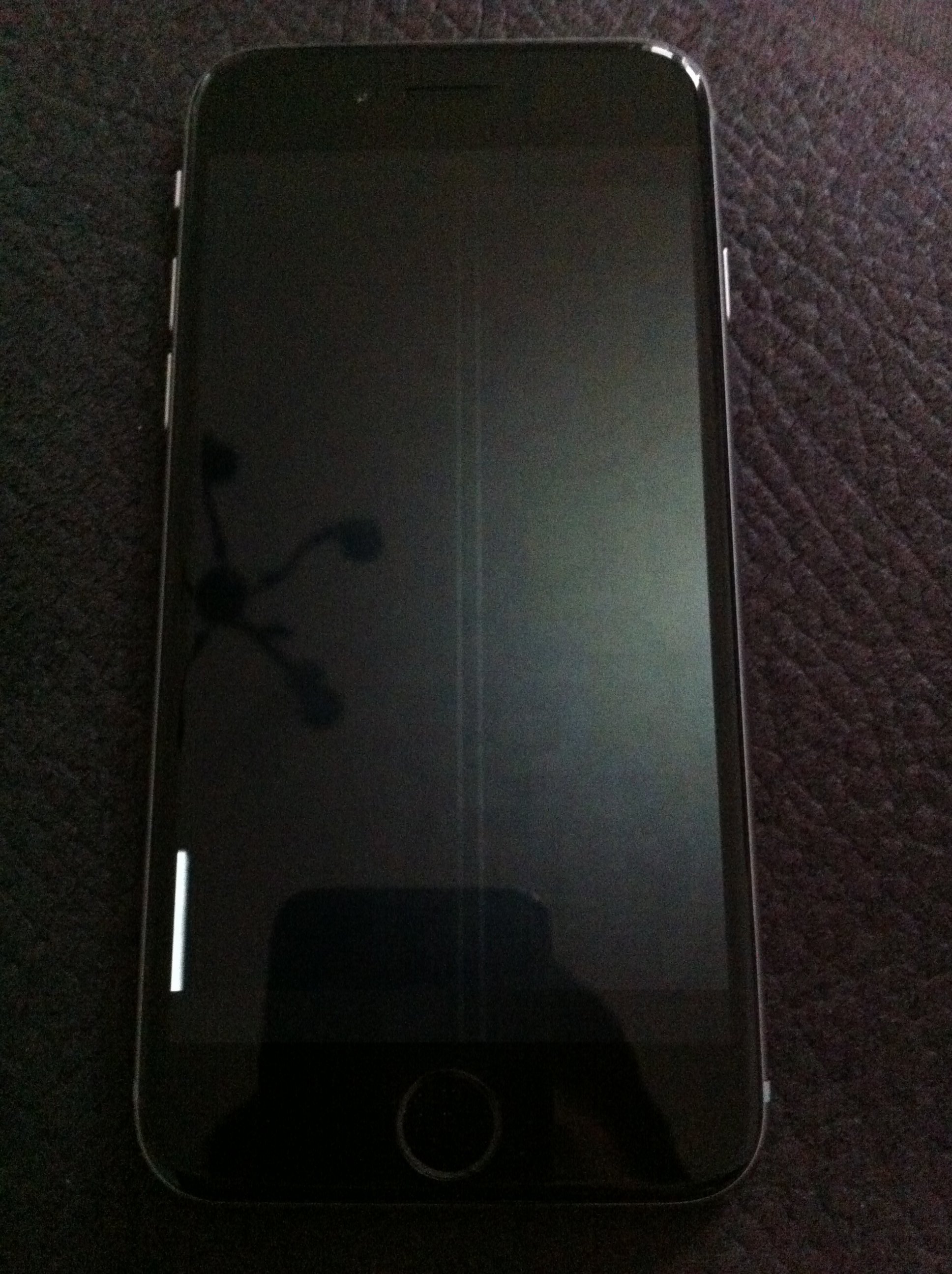

So I recently dropped my iPhone 6 on a hard tile floor. There is not physical damage, however the screen now has two sets of vertical lines on it spanning from the top to the bottom which are each a fe pixels wide. In these areas, the touchscreen is unresponsive, for example, the lines go through the Y key on the keyboard and that letter is not recognised when pressed. Same goes for anything on the screen under these lines. I have to switch to landscape mode in order to type properly now. These lines can be seen in the attached picture, I have used a black background so that they are more visible.
The screen glass is in perfect condition otherwise. I have spoken to Apple and they have asked me to perform the usual tests, hard reboot, restore etc. The warranty has just elapsed on it and I do not have extended Applecare so they suggest taking it to an authorised repairer (we don't have an Apple store here in Vienna), stating that it will be either a screen replacement (cheaper) or a replacement (more expensive).
I just wondered if anyone has experienced this before and if a screen replacement will fix the issue. Or if it's the underlying capacitive electronics that have been damaged.

Ive occurred the same issue and if the phone is acting this way then your going to just have to take it in and pay the 109-129 dollars to get the screen replaced. Hopefully its not something more then that. Yes I know the screen is not damaged but that is what they did for me and it worked.

If you can get it to the Apple Store they can diagnose the problem. It could be as simple as a cable coming loose. Only they can tell.

Update: The authorised repairer checked it and confirmed that it was a problem with the screen. Given that my manufacturers warranty had run out less than 1 month ago, and that there was no other damage on the device, they contacted Apple who agreed to perform a goodwill exchange. So the day after, I was told my phone was ready to be collected and now I have a fully functional iPhone 6 128Gb again!
