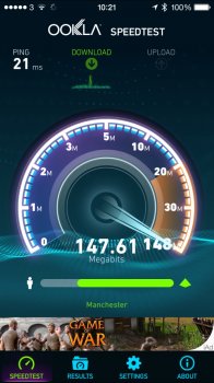

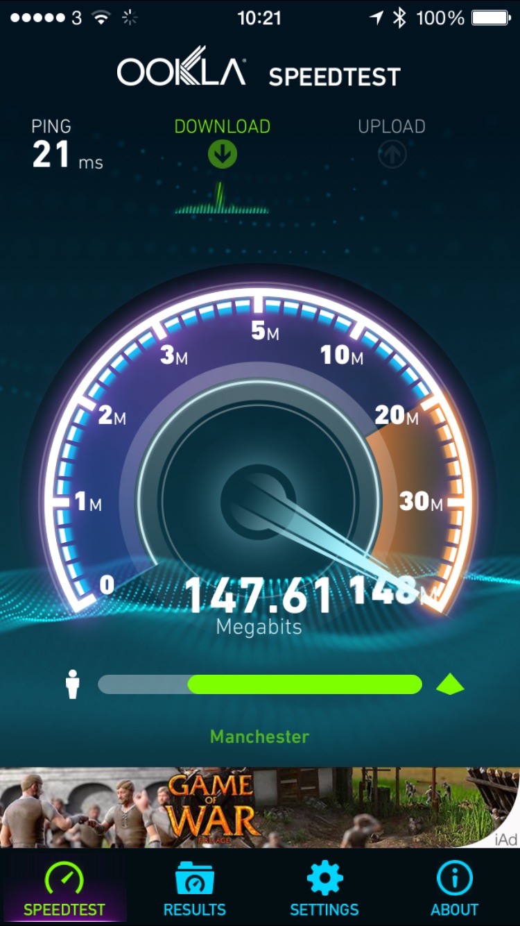

Here you go...
Here you go...
if that screen cap is from an iPhone 6 then it might have 2 x 2 , i don't know, the wifi appliance doesn't list antenna counts in the 6. if its an iPad, then thats the max speed because you only have 2x2
