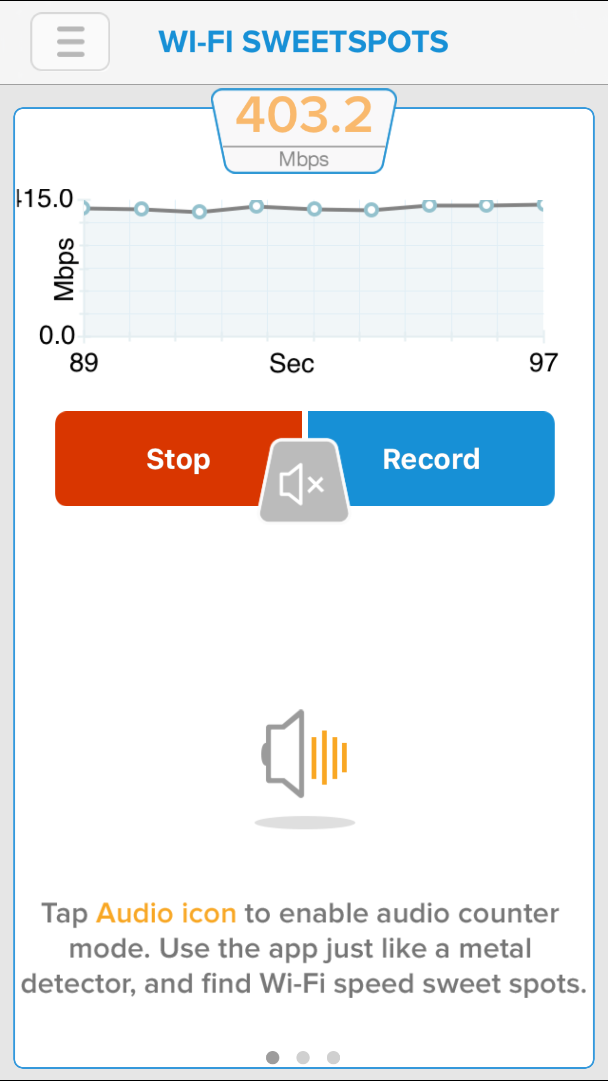

6s Plus to Airport Extreme, both MIMO units is 400Mbps this is wifi speed. Seems to be best I can get.

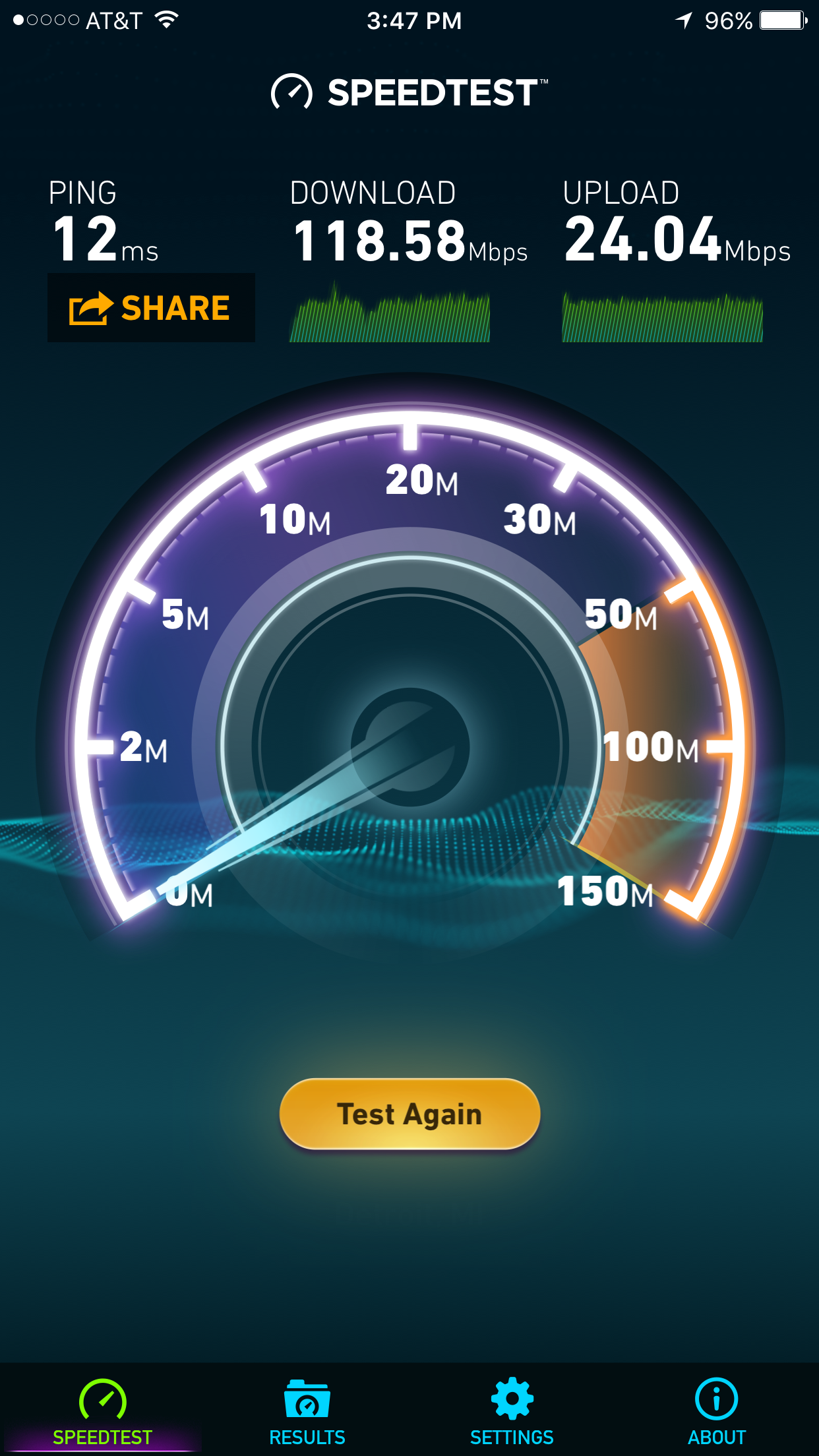

Cable modem contracted 105Mbps usually get about 120Mbps down / 25Mbps down. This is Internet modem connection speed.
Overal connection speed to the Internet for downloads is the 120Mbps.
