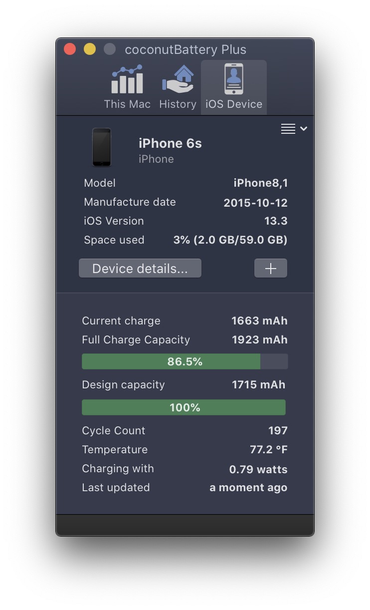

After seeing me struggle with the phone for a few days my wife came home with a brand new iPhone for me. Bless her heart. That gave me some leeway to play with the 6s. I let the battery run completely down thinking it might be a calibration issue. I did an "Erase All Content and Settings".
Finally I did a factory reset and reinstalled iOS. That seems to have worked. The battery indicator is no longer stuck on 100% and decreases with usage as expected. Coconut Battery now displays reasonable figures for capacity and current charge.
Only time will tell whether or not this fix lasts.
But, it does seem that it was neither a hardware nor battery issue.
I'm sure everyone is bored to death with this thread. However, after I did a factory reset of the phone I decided to see how long the battery would last. I did a minimal setup. No SIM. No Apple ID. No App or iTunes Store accounts. I charged it to 100%, removed it from the charger and started playing YouTube videos continuously via Safari. After three plus hours of playing, screen on all the time, the battery was only down to 84%, at which point I decided to quit.
