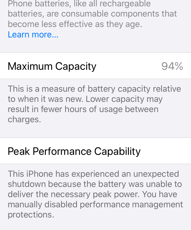

the battery health is at 94% why would it need replacing? it worked fine on ios 12 doesn't make sense.

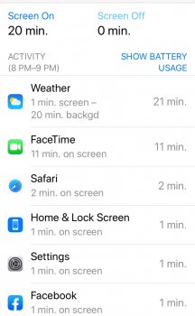

Post up a battery usage screenshot. Something must be rogue software or app wise to cause a full charge to be depleted in 20 minutes! Have you tried a fresh install via iTunes by putting the phone into DFU mode? That may help.

Yes you can go back to 12.4 but your battery is likely shot, so even if you go back you might encounter the same problem soon. Is it the original battery and several years old? If so, it's more than likely it needs to be replaced. Try running the battery down to say 10%, and then see how your battery does.
In my experience for a very old battery it's fairly common for battery health to read OK at room temp when near full, but cool it down after running it down to a low amount, and it goes haywire if it's in equivocal condition.

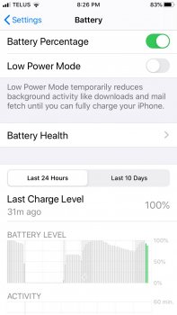

All apps are downloaded from the app store... also I just used it for 31 minutes from 100% went to 83% just like that barely used any apps as you will see below...
