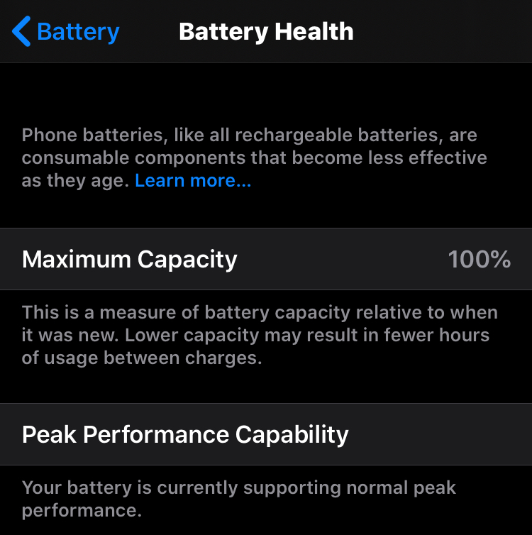

Hi, I bought an iPhone about 2 months back and I’ve been having some problems with the battery it seems. When I first bought it from the guy it was having serious issues with the battery, it could barely hold a charge so I took it and got the battery replaced and it’s been fine since then but recently it’s started getting kind of.. odd? Lol. Earlier I was charging it and it was at about 73% when it suddenly said my battery was at 10% and I need to charge it (it was still connected to the charger cord at this point) so I unplugged it and it stayed at 73 but then i watched a few short videos on YouTube and then the battery was at 50 percent. I’m wondering wtf is up with this
Could be a bad/old battery. Where did you get the battery replaced? What's showing up when you check the battery health in settings?
It’s driving me nuts, I’ve had to charge it twice today already, I got the battery changed at a local place that had good feedback, I don’t know wtfff is going on with it. Can a phone be so faulty/have issues so bad that it can affect the battery this badly
The battery health check is supposedly quite unreliable with 3rd party batteries, and some 3rd party batteries are really just junk.
Reactions: Fred Zed
I’ve also seen devices that can program a battery to show as 100% battery health when they actually are not.
That's definitely one reason that 3rd party batteries don't report reliably.
I saw a video of that fella on YouTube Strange Parts. He attached a device to third party batteries and there was on option to make them appear 100% health.
