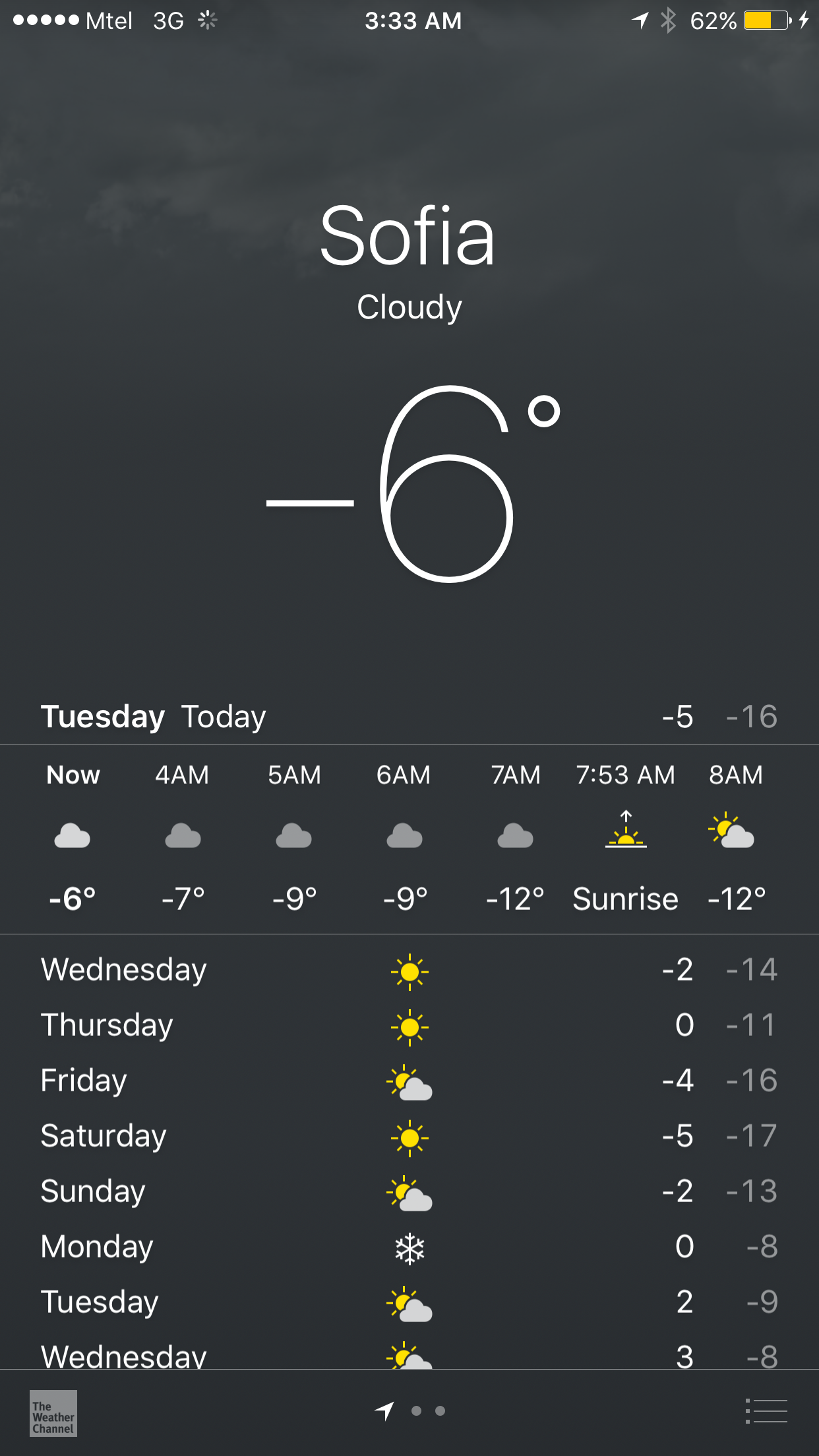

I've just noticed that my phone won't die in the cold as long as it has over 50% of battery life in it like no matter how cold it gets.My battery lasted 7 hours and 3 mins last night and it'd been on standby for 7 hours and 10 mins so could there be a hardware issue because I don't think the battery is faulty or anything

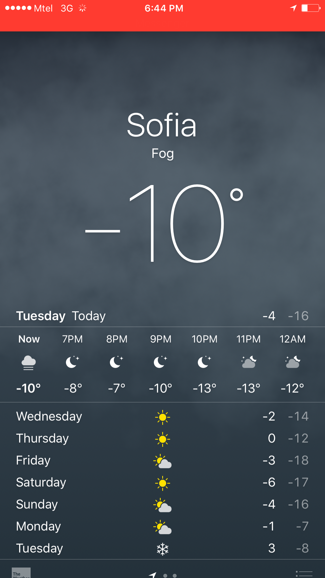

Bro in Bulgaria it's not as cold as Canada. And Note 3 is leather plus polycarbonate, not aluminum.

Are your colleagues sure their phones do not have any hardware issues?My point is...can you infer that it's normal? It
