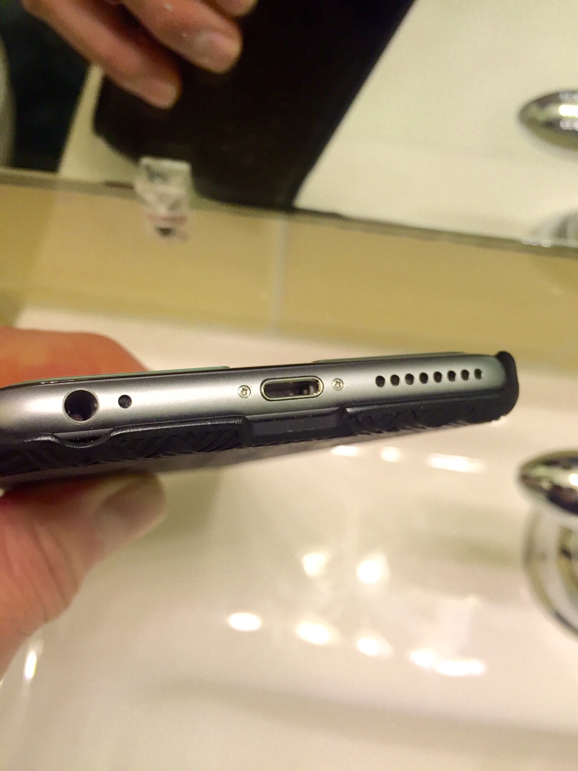

Does anyone have a solid solution for cleaning the dust/debris in the speakers on the iPhone 6s Plus?
There's so much, and blowing will damage it, trying to brush it risks pushing more in.
Or do you just live with it? I've had mine for about 6 months now...

I think you can go for a wooden/bamboo toothpick for help.

I'll give you an actual answer since it seems no one else will. Use a piece of scotch tape and dab it on the grill. You can use a toothpick to lightly press the tape on the grill to get into the corners. You may have to do it with multiple pieces of tape if your grill is very dirty.

Buy a can of compressed air at any store that sells it. Blow the dust and debris away with a few short blasts. Do not use a vacuum.
