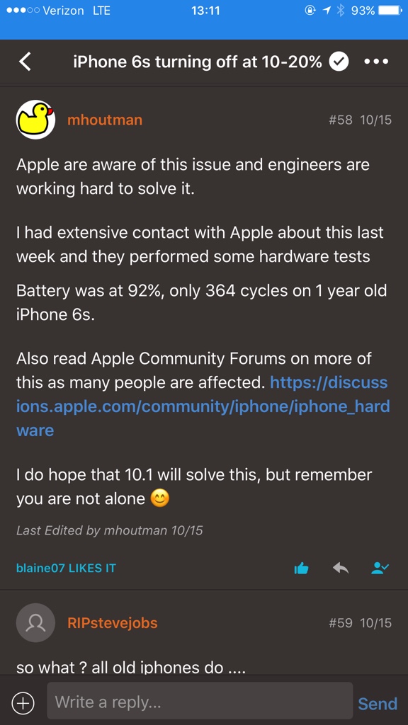

iPhone 6s turning off at 10-20%
Apple are aware of this issue and engineers are working hard to solve it.
I had extensive contact with Apple about this last week and they performed some hardware tests
Battery was at 92%, only 364 cycles on 1 year old iPhone 6s.
Also read Apple Community Forums on more of this as many people are affected. https://discussions.apple.com/community/iphone/iphone_hardware
I do hope that 10.1 will solve this, but remember you are not alone 🙂
