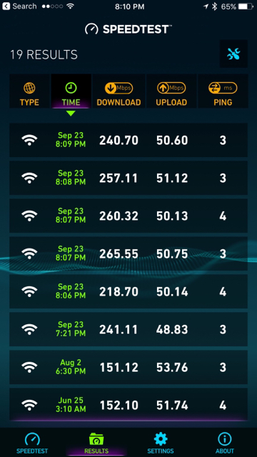

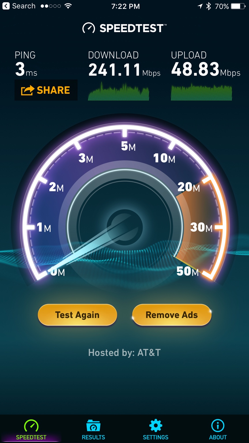

I can get the same speeds...but not all the time. Run that same test 10 times in a row and tell me if it is consistent (within reason). My issue is not one of speed when running the test, it is that the connection isn't stable.
