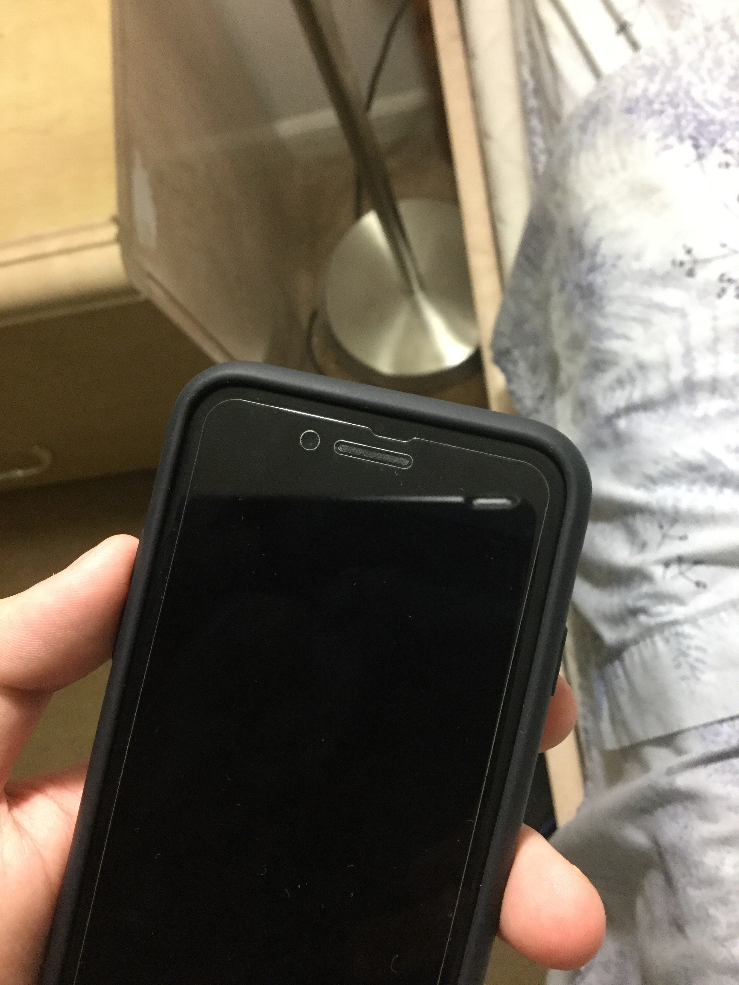

Mines worse than house this is what the apple did when they cleaned it
The response here are way off. A soft brush? A microfiber cloth? A vacuum? You don't take care of your phone? It doesn't matter? None of this is helpful; I'm sure anyone coming on line looking for a solution has already tried these things. The OP listed all the things he's tried, to no avail. Why repeat those same things as suggestions, or minimize the need to clean it?
The fact is, the material stuck in there, unfortunately, very likely IS from your body; specifically, your ears. It's not "lint" that will magically float away if you brush it. It is waxy oily dust and dirt that is pushed into the spaces between the lines of the mesh, similar to an air conditioner filter. You can't get that stuff out by talking nice to it. If you don't think we've tried those obvious suggestions... Well, let's just say we have! It's looking to me like a disassemble job, which is extremely annoying. But for some of us, the iPhone from the get-go is difficult enough to hear, and with this, I can barely hear the person talking to me with the volume all the way up. So it IS important, and it DOES need to be done. Maybe there's another site with solutions. Gotta keep looking!
