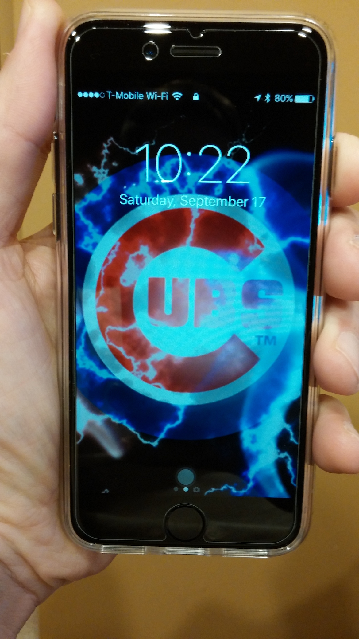

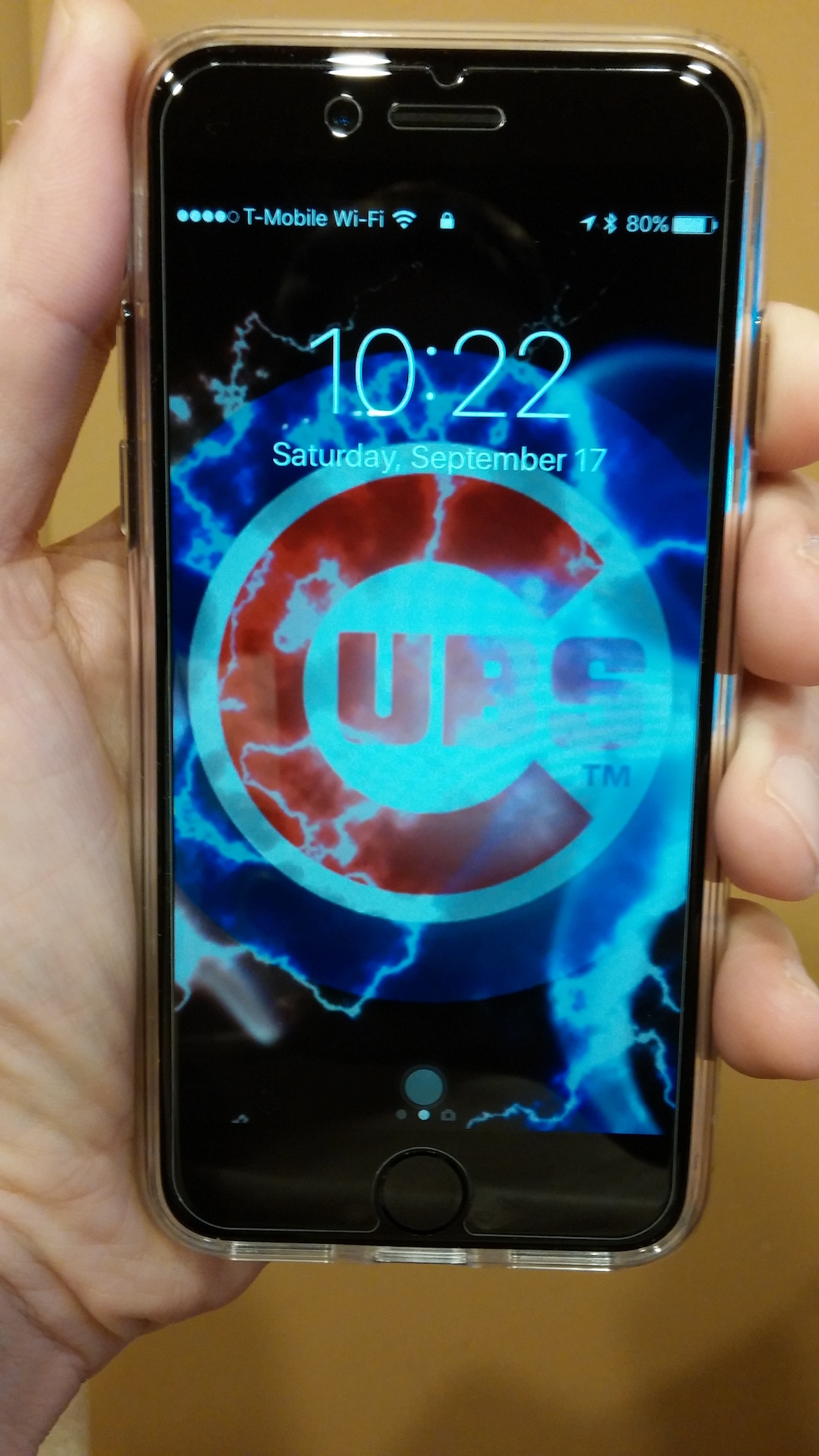

Well, discovered the first main weakness (for my use) with my iPhone 7. Without a physical home button, using an armband with a clear protector or a bike bag with a clear cover is no bueno. With my 6s I could at least depress the home button and then (sometimes with some struggles) enter my 4-digit unlock code through the flimsy clear film. But now, since the home button is capacitive, no dice.
Will they be coming out with new versions with cutout holes for the home button or bottom portion now? I guess not terrible if they had to since it's more waterproof. Or get out your scissors and hole punches everyone 🙂
Well, I found one workaround that kinda seems to work (at least with my armband and bike bag).
  1. Go to Settings>General>Accessibility>AssistiveTouch
  2. Toggle AssistiveTouch to On (green)
  3. Under Customize Top Level Menu, change from 6 icons to 1 icon
  4. Tap the 1 icon and select Home from the list
You can position the home button "icon" pretty much anywhere on your screen. However, it is present for not only the lock screen, but also every other screen. It will fade after a few seconds so it is not as annoying. Per the attached photo, I placed mine centered along the bottom edge.
Not a perfect fix, but if you have an armband, bike bag, or have it in a zip lock bag to keep it protected (I know, it's now supposed to be waterproof), you can press the side wake button and then more easily tap this virtual home button and then enter your pin to access your phone.
I'll probably leave this AssistiveTouch disabled except for when I have it in such an armband or bag.
