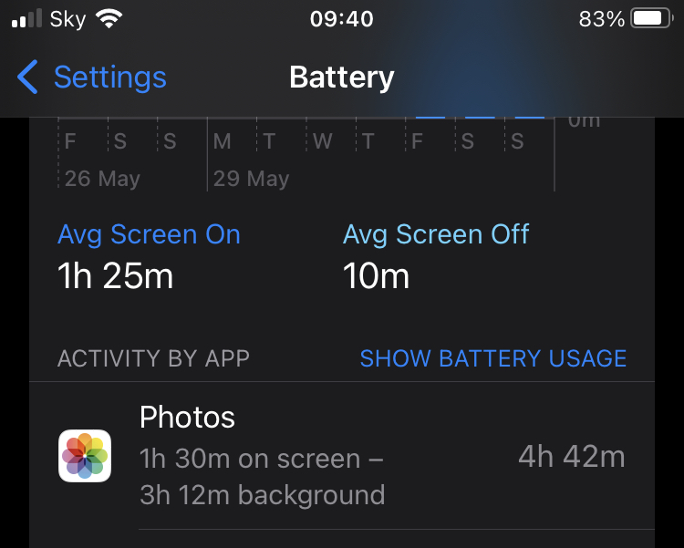

The photos app seems to be doing lots of background activity in the last few days since the swap, this could possibly be the reason?
Sounds like it. On macs, it uses a mega ton of power and sometimes get stuck. You're probably seeing the same thing. The faces thing is such a resource intensive process.
It’s taking ages to sync all photos to device and iCloud. About 12,000 photos lol hopefully once that’s complete the device will settle down with less battery drain
One way you could check would be to open the photos app and just watch it for a while. If 'new' photos seem to be appearing (or white squares filling in) then you know the app is busy downloading your photos.
I went through that last year when I bought an iCloud sub and it took my devices a while. But I have about half the photos you do and my activity was done in a few hours.

There is a lot of black squares with a small cloud ☁️ in them. It’s still syncing the photo library so will wait and see how it is after that’s finished

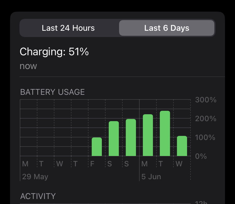

I’ve had an 8 plus running iOS 16 just fine, but the smaller 8 I have now gets hot quickly and drains battery! Sometimes the screen dims due to temperature lol
I’ve never seen the 300% scale on here before lol surprisingly the battery health is 100%! I doubt it will stay that way for long
